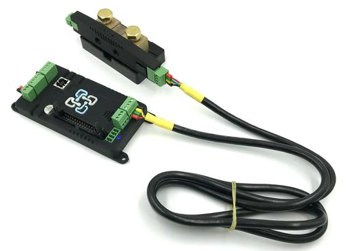

Batrium (Australia) offer a ShuntMon device which does accurate coulomb counting.
It's an optional add-on to their WatchMon battery Monitoring system, and won't work in isolation.
Nor will ShuntMon work with any other shunt that you install.
Batrium measure a number of characteristics for each shunt they buy-in.
Those parameters are programmed into the micro-controller in their ShuntMon electronics, making them a 'matched pair'.

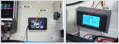

As I write this, the input from my rooftop solar arrays is almost the same as the demands being made by the home.
Hardly any current is flowing along the cables connected to the batteries.
The BMS screen shows 52.9v and thinks this equates to 92% SoC. The SoC calculation is wrong!
The cheap dedicated SoC shunt system on my battery combiner board says 53.0v and gives a more accurate SoC bar-graph around 60%.
For comparison the display on a solar-inverter says the voltage on its connection cables is 53.2v.
In practice I only ever use battery voltage to tell me the SoC, and it gives me sufficient information to avoid cell damage.

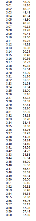

Here's a copy of the Voltage Scale I have on the wall in the plant-room.
The left column is cell voltage, and the right is battery voltage, based on 16-cells.

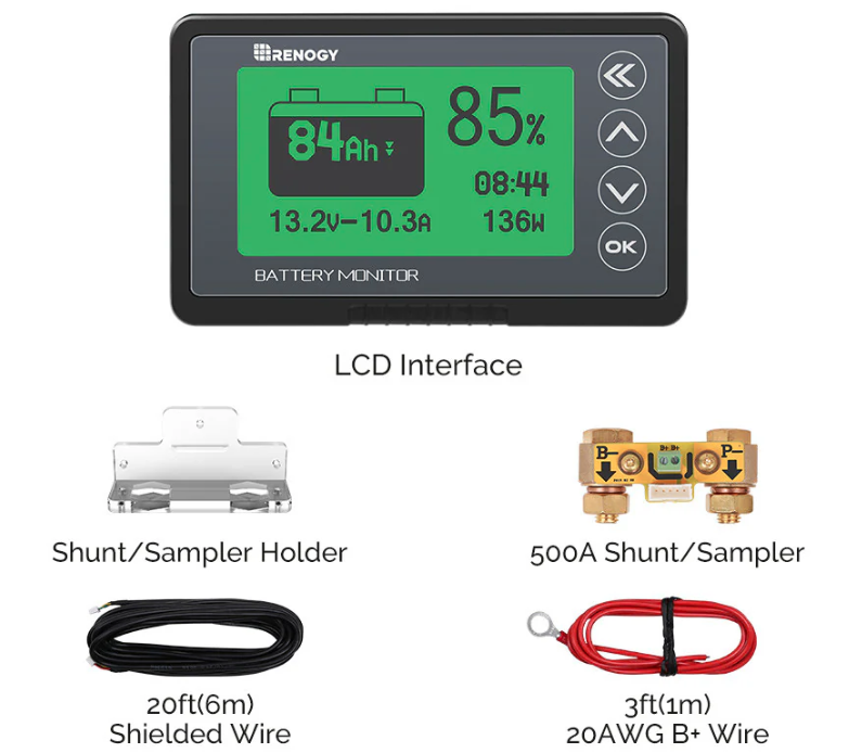

I don't have a home battery system but I am currently installing a LiFePO4 battery on a boat and have been reading up on this. The general view seems to be (for boats, but I can't see why the same thing doesn't apply to home systems at least in principle):
1. BMS SoC percentometers are a bit of a gimmick. For one thing, a typical BMS doesn't record small currents so they get ignored.
2. Resting voltage has some utility, but is still crude, plus you need to rest your battery.
3. A shunt on the negative side next to the battery with nothing else in between is the way to go, because it can measure amps, and with time, amp hours. I think I read an authoritative source (not manufacturer) saying that these are about 5% accurate. I can live with that. Adequate shunt kits (at least for boats) are not that expensive, I have a 12V Renogy one that cost around £50. I chose it because it has a large visual display of state of charge (in Ah) consisting of a battery that fills up which can be seen at a glance from a distance.

Mindful of the fact this is not a boat forum, but still perhaps relevant, I decided against the blue box premium because (a) Victron's tendency to tie you into using its other products, as you found (b) niggles eg the Orion XS 50a DC to DC charger version 1 (part number ending xxx40) caused VHF interference plus on the version 2 (art number ending xxx50) it is all but impossible to get 4AWG cable into the screw down connectors despite the specs saying it can take 4AWG cable (c) the Renogy battery monitor display is, at least for me, better (see below) and finally (d) I am not sure the blue box premium actually delivers a matching increase in quality. My LiFePO4 battery (EcoWorthy 12V 100Ah, programmable BMS - long story that one!) is still in the kitchen. The Renogy battery monitor I fitted last summer, and it has given credible readings, including times when there have been a very low drain on the (then installed LA) battery. Renogy claim +/- 1% accuracy, but I think the real world accuracy is probably nearer +/- 5%. You do have to calibrate the monitor, set the percentometer to 100% when you know the battery is fully charged, but then it seems to work fine. The monitor display and the rest of the kit looks like this, the expanded image, what you see when you click on it, is about life size, display case is 4" wide:
