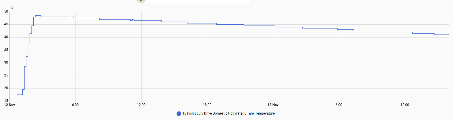

If you are losing more than 0.5-1 degree per hour then your tank isnt 'well insulated'.  Here is mine, also 210l albeit the Vaillant one, on, it seems, a day when we used hardly any DHW (perhaps we were out).
