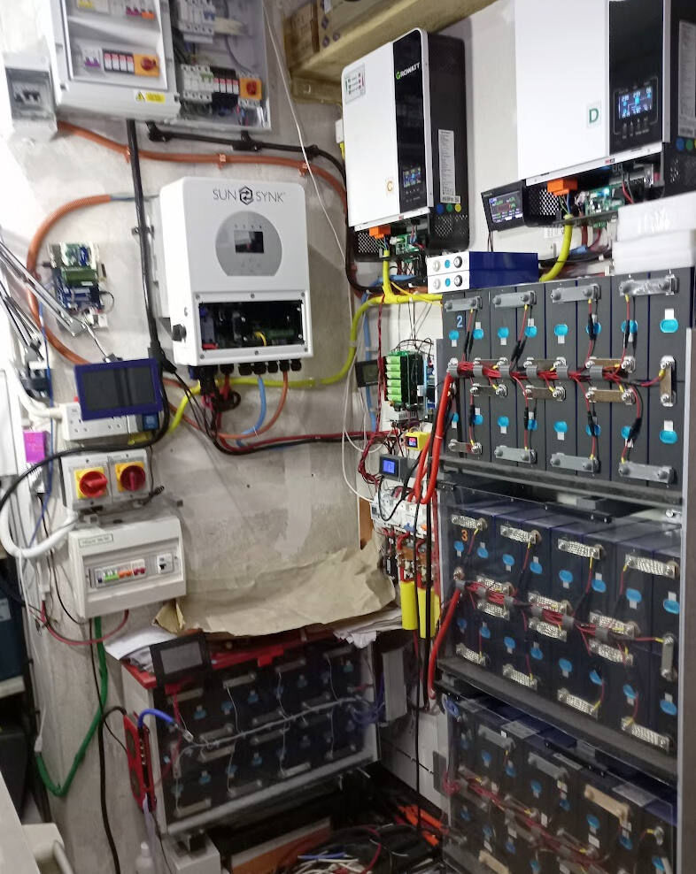

Here's a current 'ongoing project' as you call it!
I went down the storage battery route over 5 years ago.
However, the strategy was born out of a calculation (on another forum)
where I compared the amount of energy which could be stored in 3D-space to keep the home heated for around 3-hours.
The two contenders were a water-cylinder supplied from a heat-pump and an electric battery.
A lithium-based battery occupied around 20% of the space for the same kWh
Technology has moved on since then, and heat batteries probably offer a more favourable comparison.
We'd be interested to hear your views.
