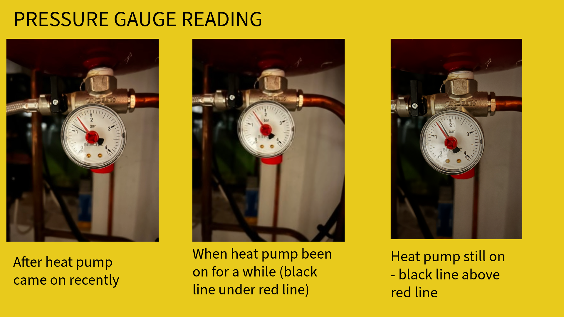

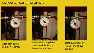

@johnbroome `yes, worth checking bladder in expansion vessel for sure.
@johnbroome if it is not the pressure in the expansion vessel then just look for a slow leak somewhere, top up as needed.
