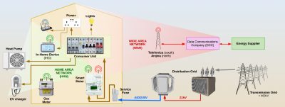

In this case I'd like to offer a new diagram, which I hope goes a long way towards explaining my technical terminology... and also where it fits in the overall picture:

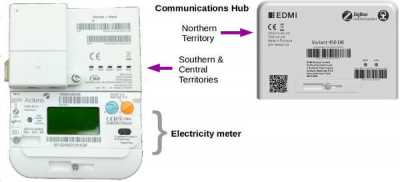

The meter readings for gas and electricity are held in your Communications Hub, bolted on top of the electricity meter.
CommsHubs
The gas meter wakes up every 30-mins to send its cumulative total to the Comms Hub and then goes to sleep again. Since the data transfer takes a finite amount of time, this is added to the 30-mins, making the whole process take around 30m,3sec. Thus the gas meter updates gradually 'creep forwards' in relation to the half-hour clock in the Comms Hub.
Your Energy Supplier supplies two further bits of data to your Comms Hub: the gas tariff (standing charge & usage) and the Calorific Value (CV).
The Comms Hub uses that data to calculate the gas usage in kWh, rather than cubic-metres, and the price, which includes the standing charge for the day including VAT at 5%.
It's the result of those calculations which get shown on the IHD.
Since your IHD continues to show electricity usage, it isn't faulty, and the wireless link is ok.
And since I'm assuming you're being billed for gas by Octopus, the gas meter and the Comms Hub are also functioning.
So the reason you aren't seeing gas usage on your IHD will be down to software.
Either your Comms Hub needs the SMETS-reset command being sent to it (the software equivalent of a kick-up-the-pants) or it needs the tariff/CV data refreshed.
The minimum permitted CV is 37 MJ/m³ but if, for example it were zero by mistake, then it would appear that no gas was being used.
HTH
