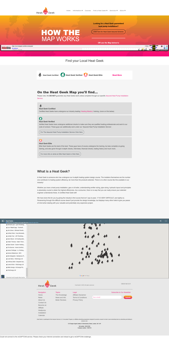

From what I’ve learned the hard way:
1) The “Heat Geek guarantee” only applies if you book through their managed platform (Upgrades/Assured).
I picked my installer from the map back in 2023 and there was no oversight or guarantee attached to that route. If your sister-in-law uses Heat Geek, I’d strongly suggest the Upgrades route https://upgrades.heatgeek.com/ where they design/QA the job and take responsibility, not the “find a heat geek” map https://www.heatgeek.com/find-a-heatgeek.

This is the old Heat Geek map I used at the time (the route that didn’t include a guarantee) to show the distinction.
