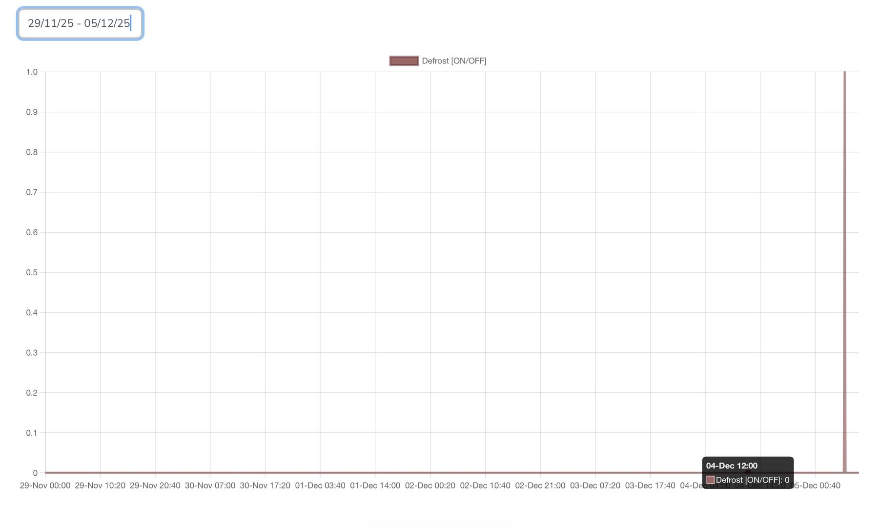

IMG 8235

Posted by: @trebor12345
The defrost occurs every 45 minutes and the defrost does clear the evaporator of ice.
Posted by: @sim0n0
Mine appears to defrost every 45 mins
Thats a bit suspicious.  Some (older?) heat pumps apparently defrost on a timed cycle rather than on demand.  I wonder if these are in that category (which might explain why you have to tell it what type of climate you have is).

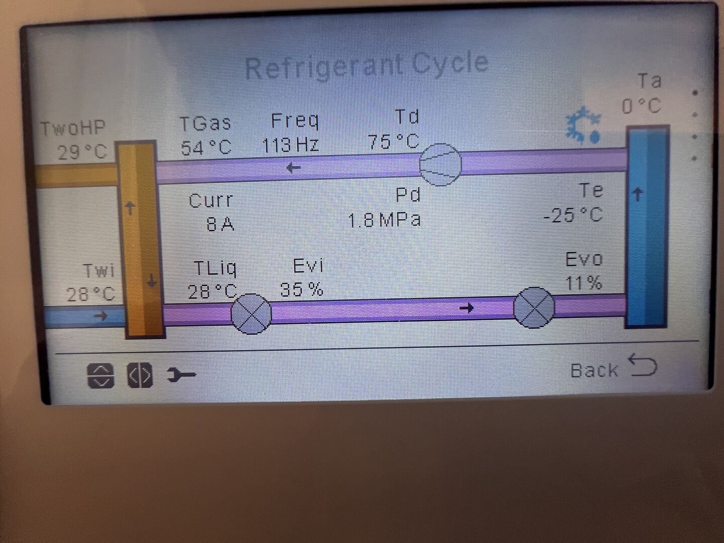

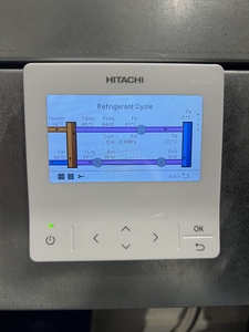

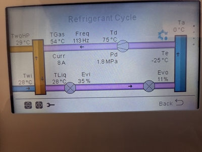

I am seeing just prior to the defrost, an evaporator of -25C. At this temperature the heat pump is really iced up and I believe the ice is touching the fan. The heat pump in this iced condition does make a rattling noise.
IMG 0475
Something odd about this diagram; the refrigerant is moving in the wrong direction for defrost - warm refrigerant from the compressor should be heading for the evaporator (at least thats how I understand defrost).  Perhaps they dont represent it properly on the diagram when its in defrost mode, in which case spending too much time worrying about it may be a mistake
IMG 0475
What did the heating do overnight without night shift, how did that affect defrosts?
I’ve noticed their graphics are a bit odd in places. I would ignore
IMG 0475
I didn't run the heating over night.  Only just now switched on.
All I can add on the defrost is that the refrigerant temperature does drop as it goes through the defrost cycle.  The image was taken the moment the HP started the defrost cycle.
