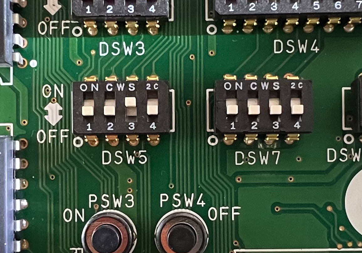

The Thermo Off (not Thermal Off) only relates to the latest SW installed by Hitachi.  To change the Thermo Off setting you have to go into the control board on the indoor unit and flip a DIL switch.
I suspect it will not work with older versions of SW.

JamesPa You will be please to know that this afternoon WE made the DIL switch change to give us a 2C Thermo OFF time.  The change was easy, but stressful.
IMG 0469
DSW5 number 3 to on.
Congratulations.
I know myself how nerve racking it is the first time you take the top off of something like this.  I added the 'cooling coding plug' (a 4k resistor for which Vaillant charge £450*) to my Vaillant during the summer.  About a day later I suffered from a series of apparently unrelated errors traced eventually to... the mesh filter being blocked - doubtless disturbed by switching the heat pump on after it had been off for a couple of months.
There is nothing holding you back now, you might even end up turning Thermo off off, or back to 4C, who knows!
* fortunately they also sell the exact same plug, under a different part number, to code for LPG in their boilers.  The charge for that - £10

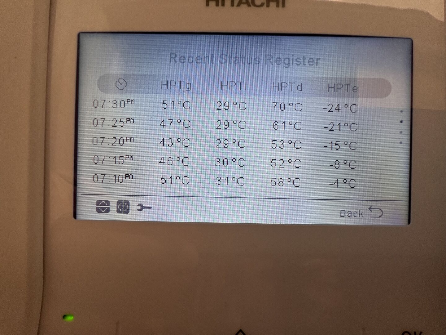

The outside temperature has tonight fallen to around 0C and I am now in trouble with defrosts.
I am seeing just prior to the defrost, an evaporator of -25C. At this temperature the heat pump is really iced up and I believe the ice is touching the fan. The heat pump in this iced condition does make a rattling noise.
IMG 0475
The defrost occurs every 45 minutes and the defrost does clear the evaporator of ice.

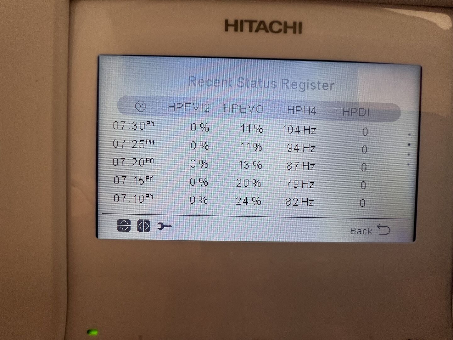

In the below UI image you can see that the frequency of the compressor rises prior to the defrost.
IMG 0477
The temperature of the refrigerant also varies (HPTg).
This image also shows how the evaporator temperature drops over the 5 minute intervals.
IMG 0476
Also the heat output to the house appears to drop.
The weight of the R32 was checked during a service visit in the summer.
I don’t fully understand the defrost algorithm, but at an outside temperature of around 0C I am sure I should not be seeing-25c on the evaporator.
Screenshot 2025 12 01 at 15.57.30
Any thoughts would be appreciated.

I can't comment on the defrost algorithm or numbers.
If the heat pump is not recovering temperature after defrost, I would turn off night shift.  Because this limits the compressor modulation, it restricts the ability of the heat pump to recover quickly.  When defrost is occurring frequently this can make a big difference to the average output.  I see this behaviour with my own heat pump the ft of which cools by about 5C if low noise mode is on and it's defrosting frequently.

James.  Yes I have turned off Night Shift.
