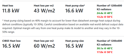

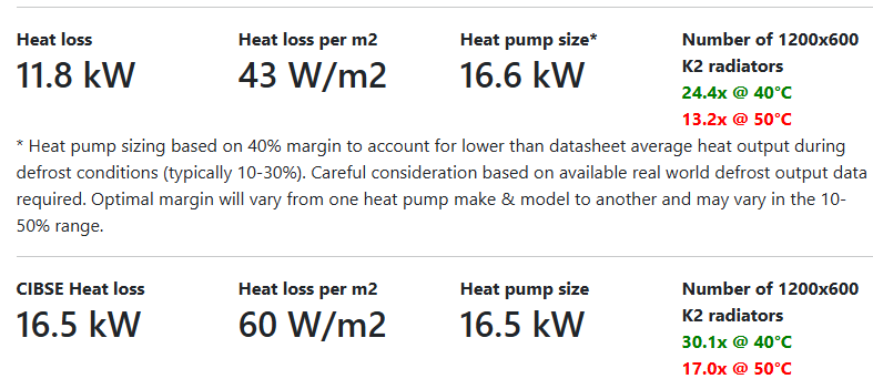

results from the simple calculator point toward 16.5kW heat pump plugging in U values from original docs. walls 0.45, roof 0.24, windows 3.5 - the simple calc will be ignoring the large lounge with vaulted ceiling i guess.

Ive done some rough calculations on those figures after trying to add in the wood and Ive come up with a demand of about 19.5kW at -3C to achieve 21C internal temperature (using the 4000 liter figure), so if James concurs then the original estimate isn't far out. (Although this drops to 13kW using the 2500 liter figure)
