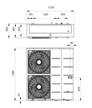

 @ericdo I believe your outdoor unit is too large to meet Permitted Development, regardless of where it is sited. The LG HM121M.U33 is listed as being 1.239 × 1.450 × 0.404 = 0.73 m^3, which significantly exceeds the PD cut-off of 0.6m^3.
Posts: 5744
Your energy: 83 kWh
Posted by: @chickenbig
I also had this thought but, if you look at the drawings, the depth is the overall depth however the main bulk of the unit is only 330 deep.  Thus its possible, but not certain, that it does in fact fit within 0.6cu m.
Thanks for checking. The listed dimensions are bigger that the measured ones. I am fairly comfortable that the measured dimensions including fan grill, but excluding piping fall into the 0.6cu m (from THERMA V (AWHP) R32 Monobloc S leaflet_(for End-user) (lg.com))
IIRC the first planning enforcement officer who came and measured it was ok with volume, but not ok with distance to fence.
The volume is important if my next step is to move it under PD. I am inclined to put in full Lawful Development Certificates application to make 100% sure this time.
