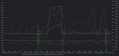

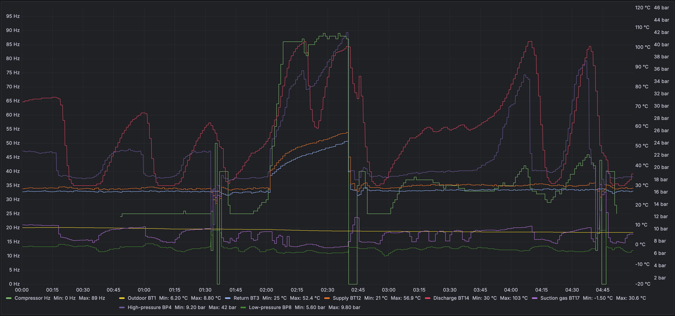

The F2050-10 was installed in March 2025 and seemed to be working well until December 2025 when firmware version 4.7.5 was released. A few days after applying the update, I noticed repeated pressure/discharge spikes:

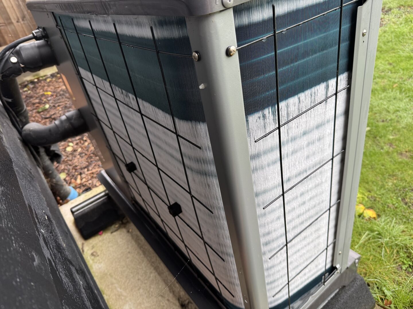

Homeowner Care seemed concerned by the high readings and agreed I should downgrade the firmware back to 4.6.4. A later update to 4.7.6 in January caused the same behaviour. Later in the month, I noticed what seemed to be abnormal banding on the evaporator. This photo was taken 9 minutes before a defrost at 3℃ outside:

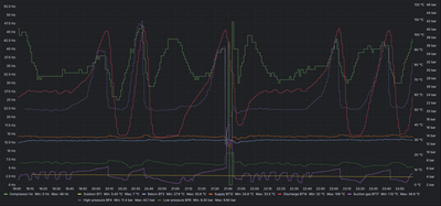

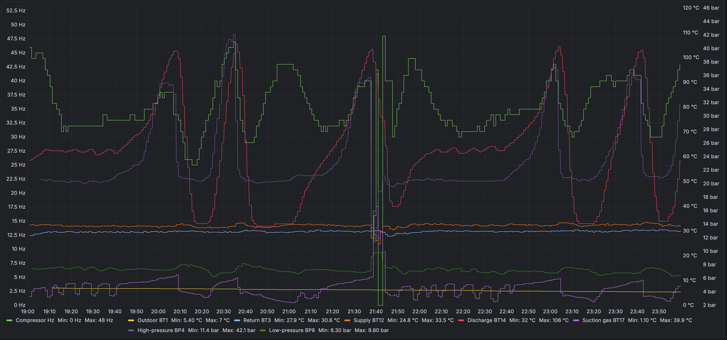

I asked my installer to escalate to NIBE, who commissioned an independent specialist to investigate. In February 2026, they recovered and weighed the gas from the F2050-10 and found it was undercharged by 290g (1,550g recovered vs 1,840g spec). An overnight nitrogen test confirmed there were no leaks, so the unit was charged to the factory specification. NIBE Customer Care subsequently stated that the unit is “operating as intended”. However, after being correctly charged, the system still appears to be unstable, with frequent high pressure and discharge spikes:
While on site, the engineer asked me if there had been any system alarms - none from the F2050-10, but I mentioned the F2050-6 had triggered “low LP cooling operation” many times. He advised this was a sign of low refrigerant, so the fault with the original unit could have been picked up in May 2024.
