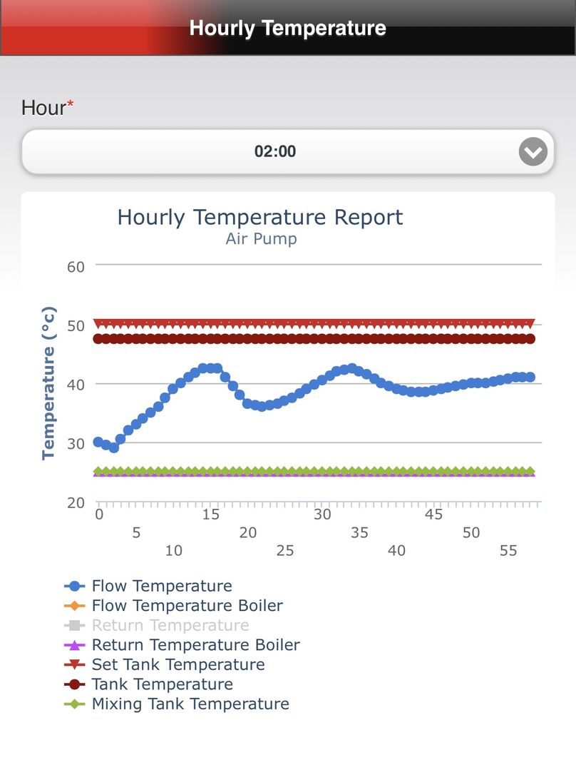

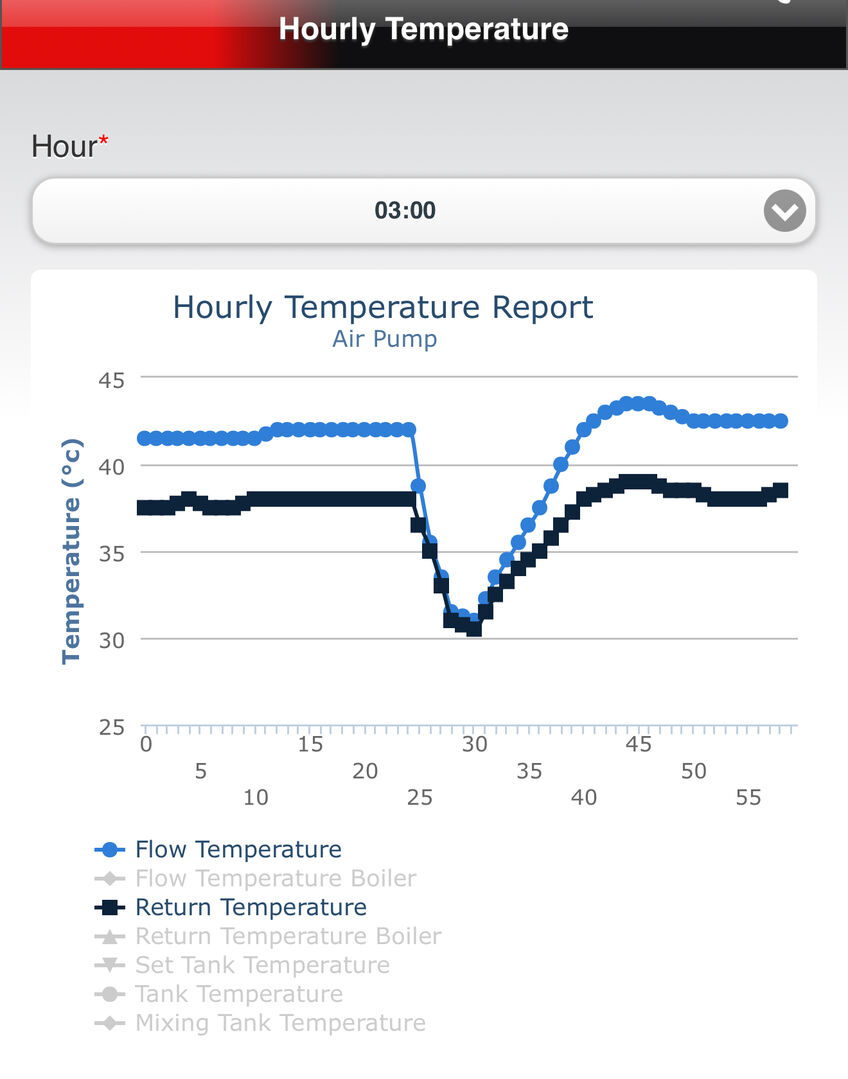

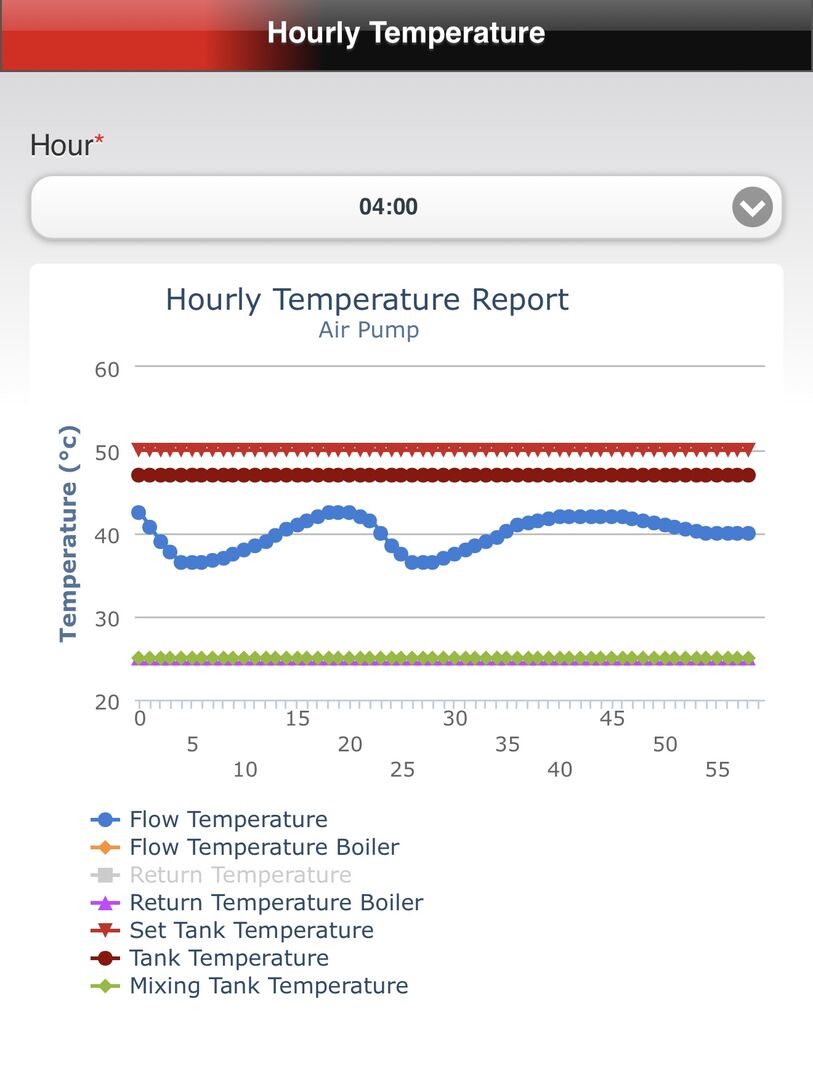

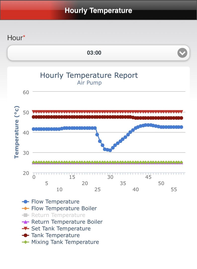

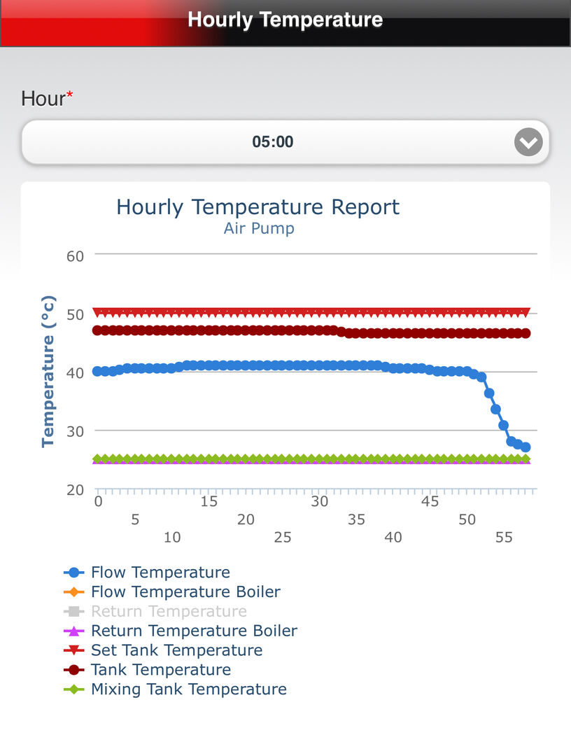

I’ve set the weather curve to -3 and 45 initially.
Looking at reports (obsessively at 5am this morning) it’s mostly stayed at a flat 40 degrees approximately but then its wobbled between 2am and 4am and its flat again for the last hour but falling right now.
I’m going to continue adjusting the curve to see how low I can get it but temperature overnight in the various room thermostats seems to have been kept constant at around the levels we’d like so I’m concerned that reducing them will cause the room temperature to drop too much but we’ll see.

(@davidnolan22)
Posts: 140

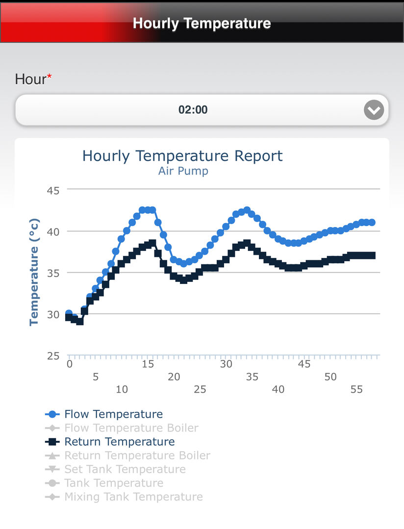

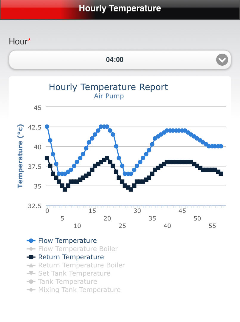

csn you post the pictures again, but just have flow temperature and return temperature showing.
this is the important temp in the primary flow snd return. Do you have a buffer tank? Or low loss header?
snd do you have the UFH design with pipe size and spacing?
and yes, set blending valves to max.
the wobbles are the unit defrosting I think, but need return temp to be sure

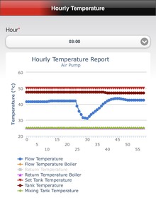

(@sandman1600)
Posts: 72
@davidnolan22 Apologies. I didn’t realise you could select which options were showing on the graph. 🤦🏻‍♂️
I’ve attached them below.

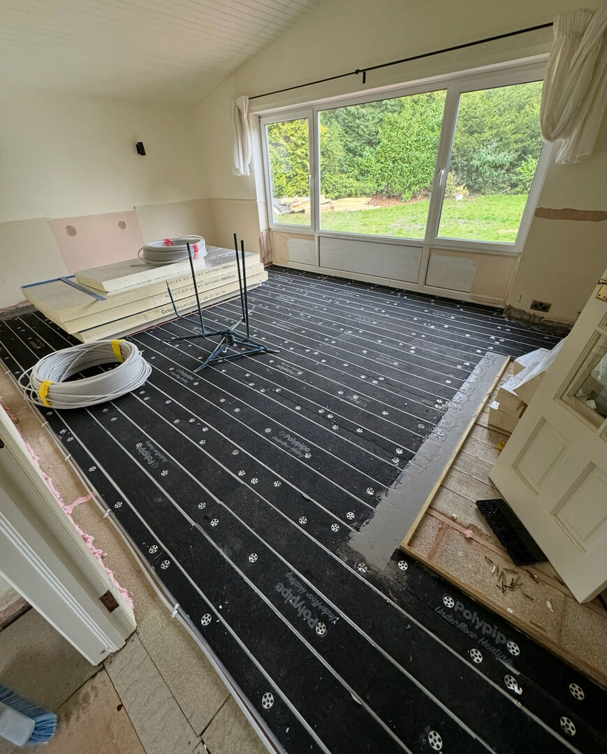

The UFH uses 12mm pipe on an overlay board with 150mm spacing. I’ve attached a photo of one of the rooms mid progress for reference.

does it have a finishing screed over it?

The pipes and overlay board were tiled on directly as per Polypipe recommendation.
