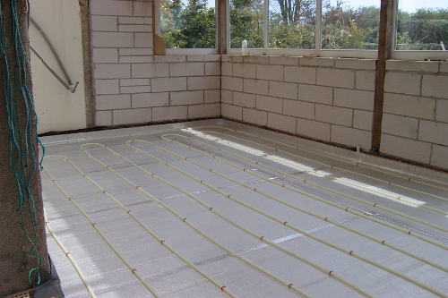

Posted by: @adamkmissus not keen on underfloor if it ever leaks its potentially a whole floor up job.
I can't see how an UFH pipe would 'leak' at some point in the future.
The time when it's vulnerable is when the floor is being laid... not after it's encased in concrete or tile-cement.

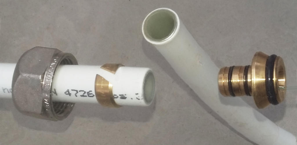

There are different materials available for UFH pipe.
When I run it beneath a wooden floor using heat-spreader plates, I use multi-layer PEX/Alu/PEX
where PEX is cross-linked polyethylene:
But for embedding beneath concrete I chose a polypropylene pipe (with a resin coating on the inner wall to prevent oxygen transfer.)
That doesn't have the ease of bending which you get with PEX,
but it has far better resistance to being stood on by workman's boots when the concrete gets pumped in!
