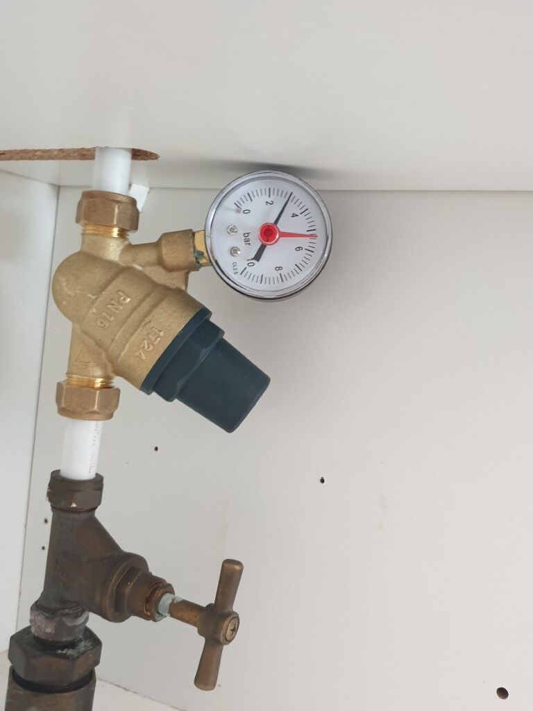

Just a little update, I eventually decided to put a pressure regulator in just after the main stop tap under the sink to bring the pressure down from the 7.5 Bar to a more reasonable 3 Bar, if it needs to be adjusted later, I can always tweak it a little.
My Heat Pump install will go ahead in 12 days and I will mention what I have done here as there will be a discrepancy in what was stated on the Heat Pump survey. I’m not sure if the installers would have done the same thing to reduce the pressure but thought I’d do it anyway just to make sure in preparation for a mixer shower that I will be installing later in the year that would need a pressure to be less than 3.4 Bar as stated in the manual.
Thanks to everyone who replied to my original post. Keep up the good work peoples👍
