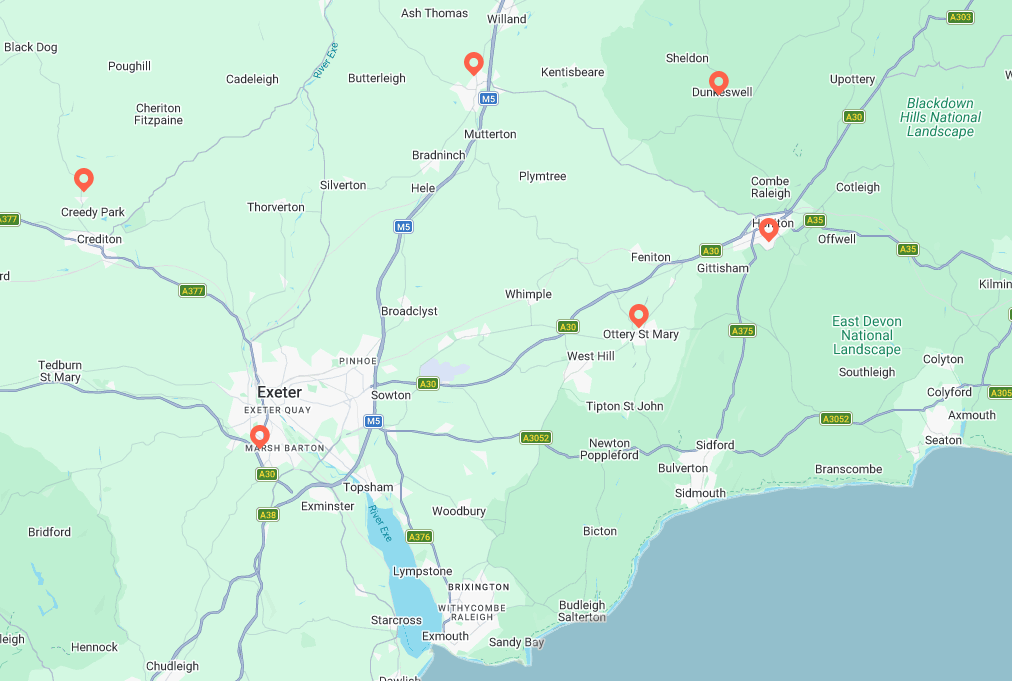

@mike-camelot Your house is an area which has been extensively flooded overnight.
Can you give us any news on both the way your SIP house has been affected, and the situation in the surrounding villages?
Here's a snapshot of NGED's power-cut map for 11:30 today (27th Jan) showing East Devon where Mike lives.
For the benefit of readers in other parts of the UK, the main A30 has been closed due to flooding east of Exeter.
Yesterday, the Leader of Devon County Council, Cllr Julian Brazil, has stated that the region lacks resilience.
That's true in so many ways: roads, railways, internet connectivity, electricity supplies, housing, ecological imbalance and food production.
There's probably a lot of 'knowledge' on this Forum which could be tapped into, with a view to developing a more resilient society and infrastructure.
The 'solutions' are not going to magically appear from Westminster.

@transparent No problems today. We had a power cut Sunday night Monday. I don't what time the power went off.It came back at 01.32. I think that it was about 1 hour duration but I can't be  certain. I have lived here for 2 ½ years. In that time there have been 3 other cuts. One lasted for 18 hours when a sub station had a problem.

Thanks Mike. Glad to know that you and the house are both intact.
I have access to many of the NGED in-house data and network maps, within a 'partnership agreement'.
That means I can 'see' the connections in your area, and statistics on the physical cables.
Whilst I don't know which is your house, I can already see that you are connected to a pole-mounted local substation, which will be one of:
  • Awliscombe 31/1248
  • Losses Farm 31/4426
The substation reference number is on the pole at 2m above ground level.
The '31' refers to the Bulk Supply Point (transformers) from which the 33kV cabling originates that you are connected to.
I have a particular interest in increasing network resilience.
That means I keep a lookout for areas which suffer power-cuts more than once for the same reason.
