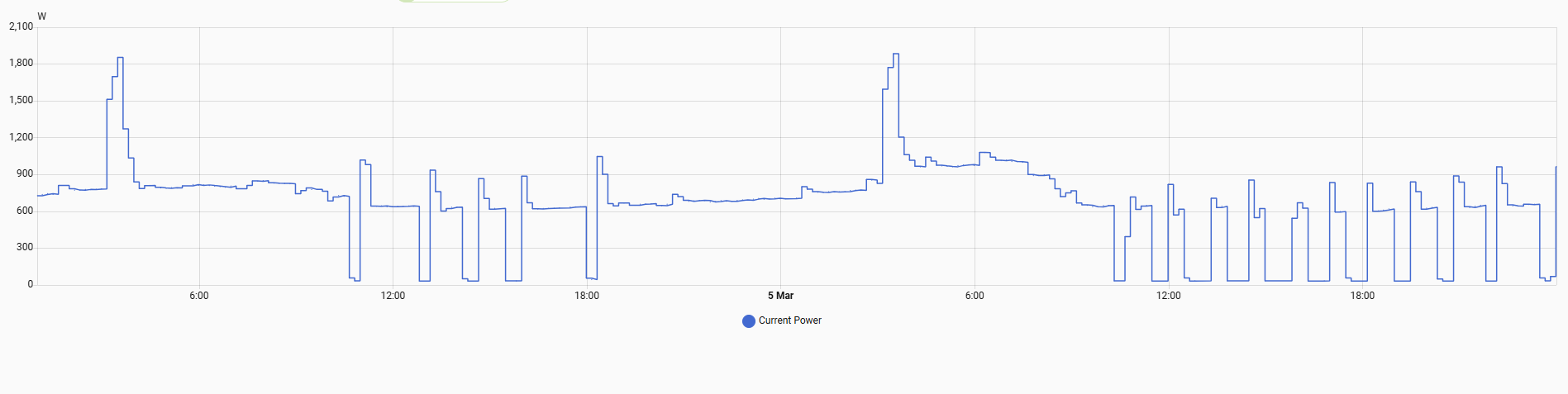

The fact that when the demand (ie house loss) is less than the minimum that the heat pump can turn down to' the heat pump will cycle on and off so that on average the demand and output are matched
Like this (from my heat pump) between about 11am and 1800 on the first day and after 11am on the second day.
