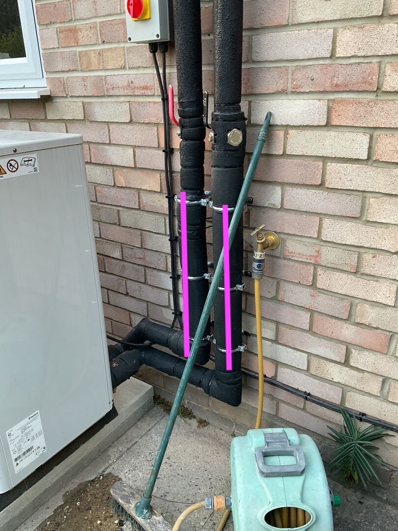

sorry i needed to be more clear, is the pink the flexes?

if you fix the thing that is supposed to be free moving to absorb vibration to will pass the vibration down the line, flexes need to be free floating either behind the unit, to the side or through the wall but always free to move.
11890 IMG1161
Well at least its well insulated, but Im not sure that insulation is fit for external use.  Others may recognise it as either internal or external grade insulation, I thought external grade usually had a shiny coating but there may well be a variety that doesn't.
Its impossible to tell from a photo whether the section marked is flexible, but if it is why would you put a clamp in the middle and why would it be perfectly straight?  It needs to be free to move as @ashp-bobba says, supporting it half way defeats the point!
Installer to fix the noise and confirm that the insulation is external grade IMHO.

@ashp-bobba yes the flexis are there.
they didn’t do a base they just sat it on some paving edging pieces stacked on top of each other then on top of my old concrete path that runs along the back of the house.

@jamespa this is the third attempt to sort the flexis as the first time they were fitted they were not insulated properly and they changed one when they returned to finish off. But I then found out they were supposed to be straight and not bent 90 degrees so they returned and fitted new ones on the wall as it was about the only place they could go in a straight line.
the insulation is primary pro so is outside rated.
im pretty sure I’ve had this noise with the flexis in different positions so not sure it’s that. I suspect it’s either the base transferring noise up the wall, which would explain why I can hear it in the lounge which is about 5m away along the back wall, as I would have thought if it was the pipe work it would be near silent apart from the kitchen where the primaries are.
I agree with the logic, the installer needs to sort it, you shouldn't be experiencing the noise!
