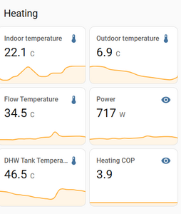

Not so far as I know.  I dont think that is reported by the API unfortunately.  Here is what I have on my 'dashboard' which, in practice, does almost everything I need.
Ignore the Heating COP tile, that, together with all of the energy consumed stats (but oddly not the current power stat) has flatlined since 26th Oct, for reasons as yet unclear.

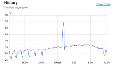

If you have HA up and running watching the flow temp or the power tells you its cycling.  Here is my FT

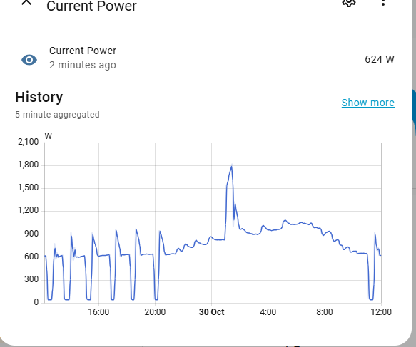

and power
showing cycling until 20:00 yhesterday, then a period of steady operation (because it got colder outside) and now (because its warmed up outside) starting to cycle again

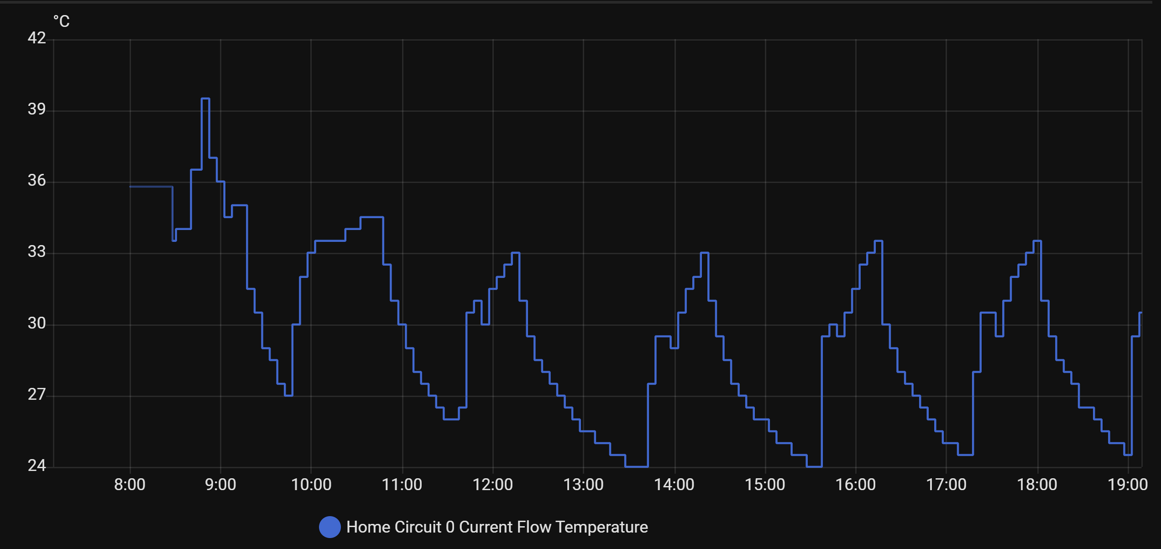

(@adamk)
Posts: 229
@jamespa this is my flow temp graph. doesnt look as smooth as yours, ignore the spike at the beginning that was me messing with settings:
