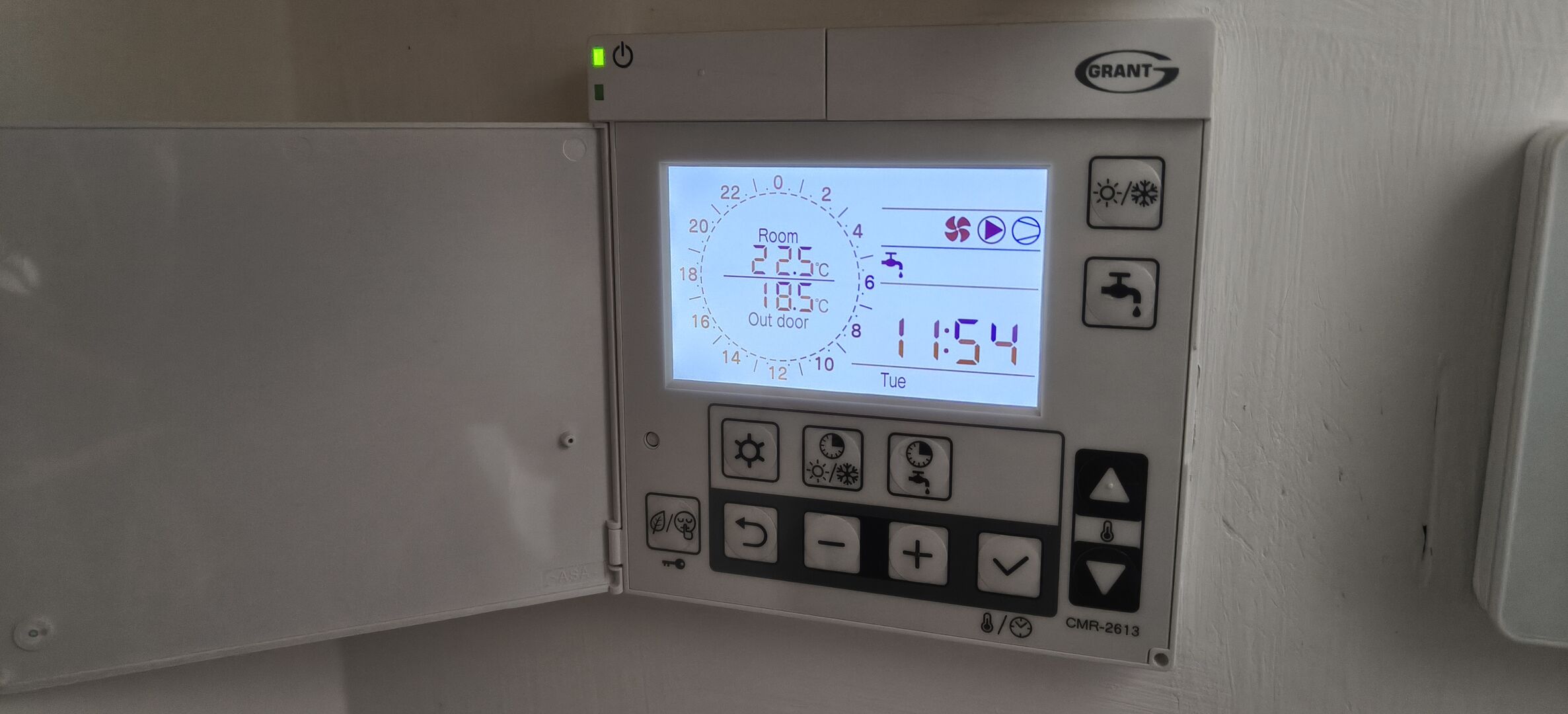

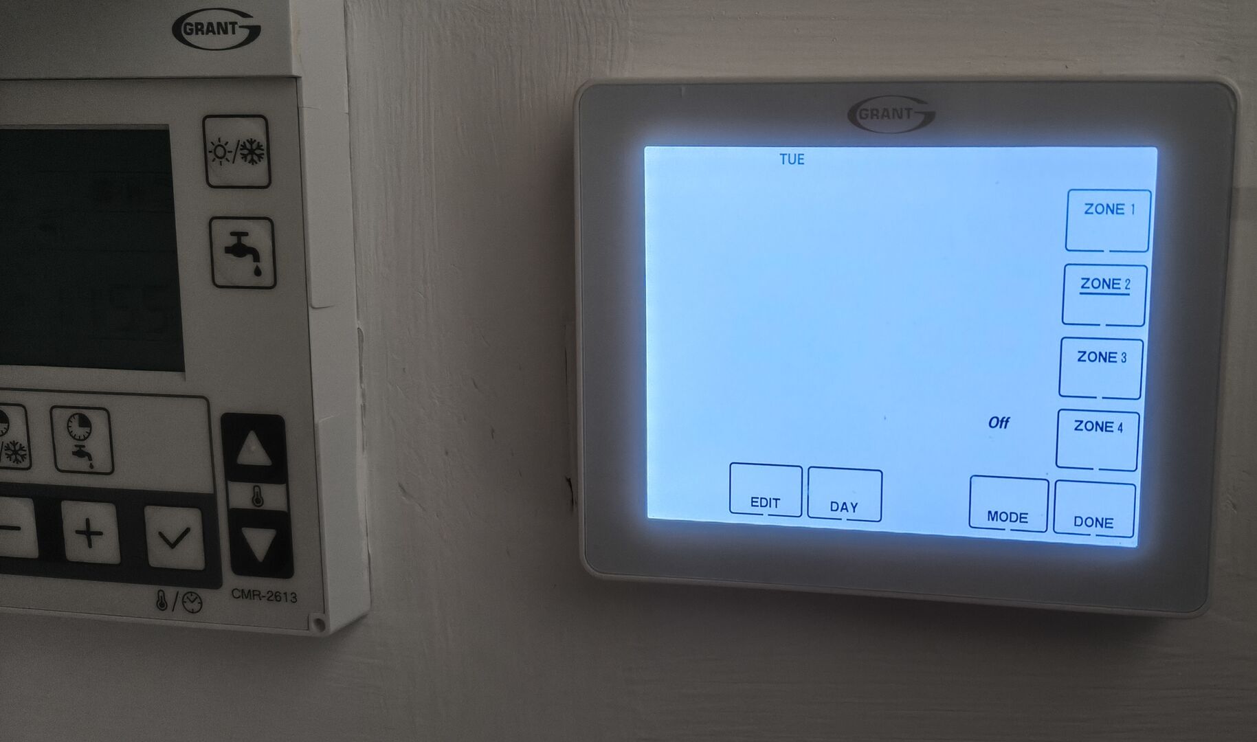

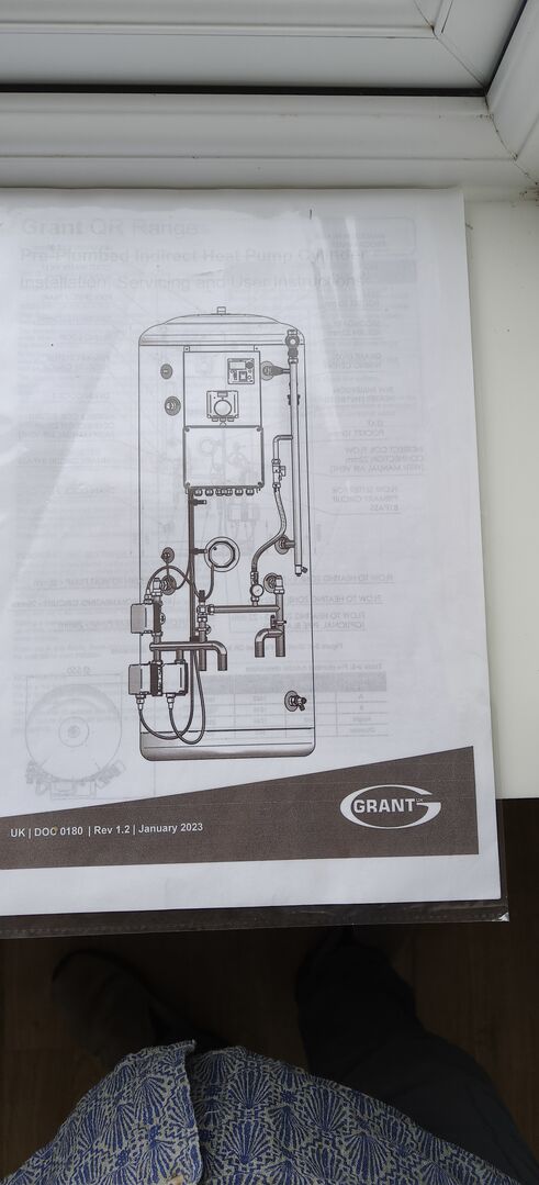

My neighbour had the Grant ASHP & cylinder installed along with the Heatmiser system plus several wireless thermostats. She has a manifold with underfloor heating.
They had a poor handover & no literature at all.
Even though the thermostats are not on demand the system fires up - see photo.
I think she needs to engage a local heating engineer to work thru this & to ensure it is all working. It did work fine for the first year.

Thanks for the info and pictures.  They tell us s lot.
As I suspected she has too many independent controls fighting each other.  Basically too many bosses.  Sadly a large proportion of heating engineers won't have a scooby how to approach this.
The solution is to disable most of them by turning thermostats/trvs/mixing valves to full and setting them to operate 24*7, then use the grant controller alone, setting up weather compensation and balancing.  Also if there is a secondary water pump (because a buffer or low loss header has been fitted) that will need to be considered.
That's a radical change which she may struggle with initially but is the only way ultimately to make it work both sensibly and efficiently (and most comfortably). There are also ways to make it work more or less sensibly but less efficiently and less comfortably that involve a less radical change.
Happy to provide further advice but only if she is prepared to stay the course and forget  everything she has learned about running heating
Otherwise I wish her the best of luck finding a heating engineer who can put her on the right course.  They exist of course, but there are lots out there who just can't think through multiple control systems acting in parallel and thus in conflict.  Fundamentally this is not a heat pump problem, it's a control systems problem where the problem is too many independent systems.
