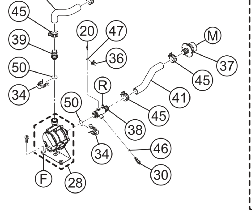

My hunch is an issue with the primary circulating pump. It's relatively easy to remove for inspection change out, and a competent plumber could do that. A primary pump replacement is not new monobloc territory cost. You wouldn't change out a combi for a failed circulating pump, so surely it's not unreasonable to expect Grant to hold circulating pumps as a spare part? Even if they don't the pump will be a generic product and you may be able to source a replacement yourself. Grant are stockists of badged up Chofu units, probably with little spare parts holding in the UK. Dare say they'll probably advise changing the whole monobloc for relatively minor component failures which could and should be repairable.
The grant pump isn’t pwm controlled so you could literally fit the cheapest one from toolstation and it would work without error codes.
Grant have now agreed to replace the circulating pump to see if that's that root cause of the issue this week as it's been power flushed twice with fx2 and another stronger chemical already and the water didn't look that dirty according to the heat engineer. He was expecting it to be black and it wasn't that bad he said. The power flush is using a Kamco flush which has a flow of 200lpm. So fingers fingers crossed it's the pump at fault.
@hughf sorry what does pwm controlled mean? The Grant pump is a pretty powerful pump with 12m head I'm told and as it's the only pump we have now it would need to be at least as powerful.
