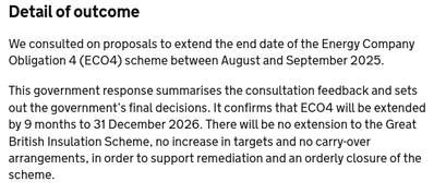

Posted by: @transparent
News Update from DESNZ. They've decided to extend the ECO4 scheme.
I suspect a large percentage of insulation jobs were carried out under the ECO4 scheme, so perhaps this fits here.
One thing I can add is that when we were looking to carry out our (self-funded) external wall insulation, we had a few companies that came and that I now understand were doing a lot of ECO4 work.
Their salespeople really lacked the experience of what was required and showed signs of poor oversight in the big jobs they were working on for local authorities and housing associations, like:
  • Generally stated they would only fit 200mm of EPS or rockwool (the cheapest materials)
  • They were happy to sell warranty and claim some industry certification but would not get engaged in any discussion on insurance backed ones (yes, there is a niche industry for this work now..)
  • Some had special companies they were using for the big work.. And I spoke with some directors that had got so used to it that they could not consider doing work under their original company name
  • Some stated that they would always need to fit permanent low speed fans, to prevent mould. Our thought: we pay our own way, we have fans, why are you trying to add to the job? I now see that the method of leaving a short gap between wall and insulation to prevent damp was too time consuming..
  • They were also not able to provide any references for previous work (even if they were clearly doing lots of it)
  • Some confessed they could not be sure of the quality of the work, as they did not know who would assess it
After this, I contacted some system specifiers/warehouses that would provide materials warranty. They suggested installers. We made both the material and the labour warranties part of the contract and schedule of payment and it worked very well. It helped for a more relaxed process that we had all the details of the inspection regime from system specifiers before we even paid the deposit.
