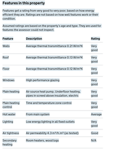

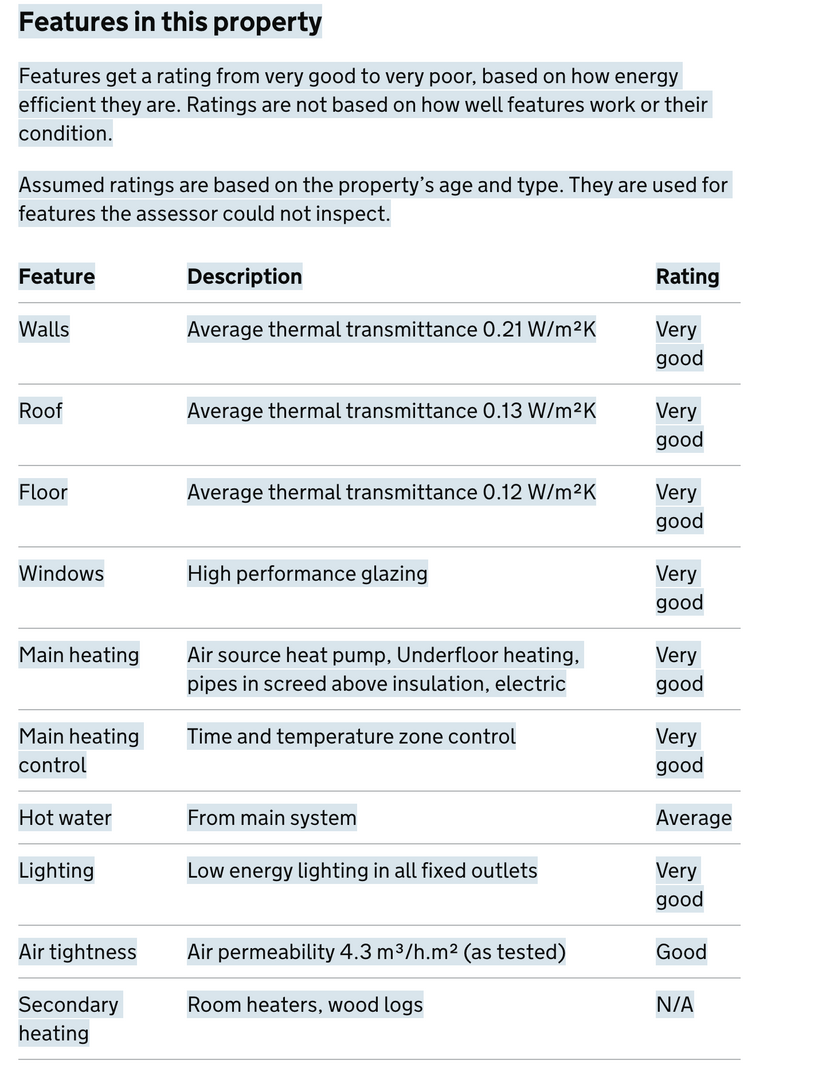

What is going on? I found his EPC online (see attached). The big difference is that the assessment was a SAP one (from 2020), not RdSAP (from 2017). It rates a number of features that don't appear on my shorter certificate. It looks like the SAP assessment enables more specific details about a property to be recorded, whereas the RdSAP makes general assumptions that may be less favourable.
For example the description of the heat pump says a lot more - ASHP, Underfloor heating, pipes in screed above insulation, electric. That is exactly the same as my installation except the EPC omits the additional wording about the pipes. My friend clearly also had the actual thermal performance of the walls and the overall air tightness tested.
So back to Elmhurst Energy to find out if a SAP assessment, instead of an RdSAP one is likely to produce a better rating. It will no doubt cost more.
It is like getting blood out of a stone talking to people in this industry.
Mike
Extract from my friends A 100 rated EPC. His house, like mine is a mixture of old and new build
@mike-patrick I'm no expert... but believe your ASHP is incorrectly rated under all scenarios!
Possibly they failed to find the make/model in their system and used an incorrect placeholder.
My understanding...
SAP is used for new builds: The full SAP assessment is required for all new domestic dwellings, as well as for conversions and extensions.
Used for existing homes: A simplified version of the methodology called Reduced Data Standard Assessment Procedure (RdSAP) is used for existing dwellings.
So it's quite possible your works etc should be under SAP?
I suggest try asking Assessors for a quote to do SAP assessment based on evidence etc. Hopefully around £80?
