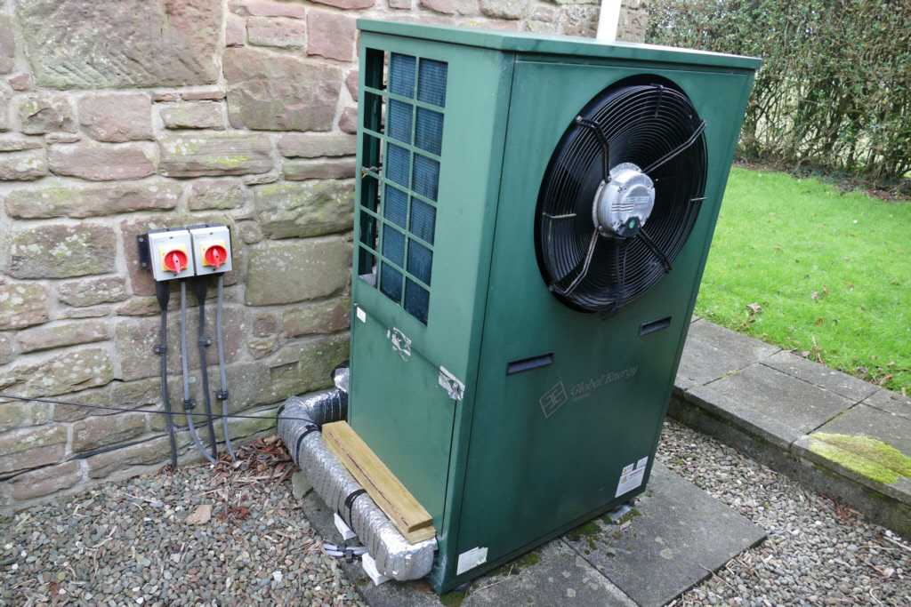

The system is a Global Energy Systems Thurso heat pump, paired with their specified UK-made World Heat CLIMACYLSS dual tank, containing 300 litres of hot water and a 100-litre buffer. A separate pump feeds the radiator circuit via approximately 22mm pipework running the length of the house through the attic, with 15mm drops to the radiators. There is a single heating thermostat in the hall.

There was also a serious manufacturing fault. The external evaporator fins overhang the casing on the left-hand side, allowing condensate to run down between the panels and into the machinery below. Directly underneath sits the booster heater, with wiring on top, and below that the internal water pump.
The booster heater failed early on, so early that Joe did not even realise there was a booster. After we bought the house, the water ingress then destroyed the internal water pump. Global Energy charged my partner around £800 to replace it. They did replace the booster heater free of charge.
