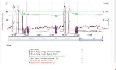

Hi all - I have a Gen6 Samsung ASHP linked to a thermal store. Stratification is (has) supposed to keep the top for DHW. My temperature sensor for DHW is in the top most slot of the thermal store.
Over the past 2 months, I've had DHW generation set to 50C. As you can see in the attached graph, I am losing 10C within 30 min and then another 10C over the hour. It seems to me that my stratification is collapsed, as the temperature is being pulled down very rapidly to my central heating target. And our radiators get much warmer during the DHW generation.

@jamespa - thanks for the reply.

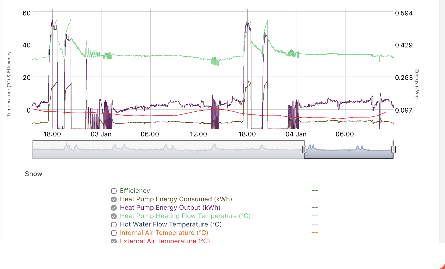

You've made me look at these traces more carefully. The green trace is what I've been looking at and it's the heat pump heating flow temperature. It can't be the tank temperature as it gets to 50 in 3 min!
The DHW temperature is missing and should be a blue trace labelled as "hot water flow temperature". I think.
This suggests that we may have an issue with the sensor... I'll work on that, and look for any issues with diverters too.
Posted by: @andbeck@jamespa - thanks for the reply.
That was what confused me! The heat pump FT is doing what you would expect.
