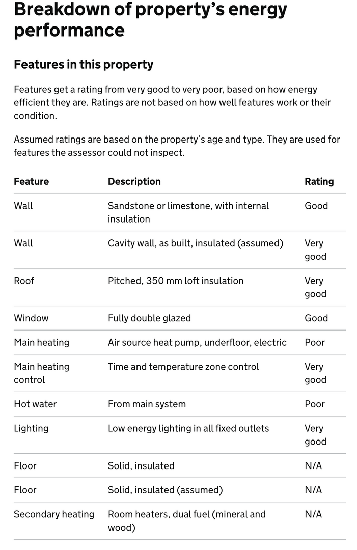

Attached is the page from my EPC which shows the Poor rating of the Main Heating and Hot Water. You've prompted me to look at the same page from the EPC from when we bought the house and before the retoration. Overall it had an F rating but the important point was that it had storage heaters and used an immersion heater for hot water. On the old certificate these were both rated Average! Storage heaters better than an ASHP - that can't be correct?
Screenshot 2025 09 30 at 09 37 45 Energy performance certificate (EPC) – Find an energy certificate – GOV.UK
So maybe some wrong boxes were ticked when the EPC survey was done. It was the same assessor in both cases although having checked I find they are no longer an assessor. Is it possible to access the detailed report which shows what data went into an EPC to check this?
Mike

@mike-patrick  I think at the time of your EPC the heat pump would have come out badly - but things have changed since then. So maybe less a case of box ticking incorrectly... more the changes in calcs.
The controls will help on new EPC as well especially if you use weather compensation and have Thermostats/TRVS (even if unused).
I'm not sure if your underfloor insulation should show as a rating help? But may need evidence? e.g. receipts, pics etc
It needs an assessor willing to spend a bit of time on the survey as well as completion of the modelling.

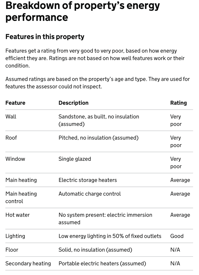

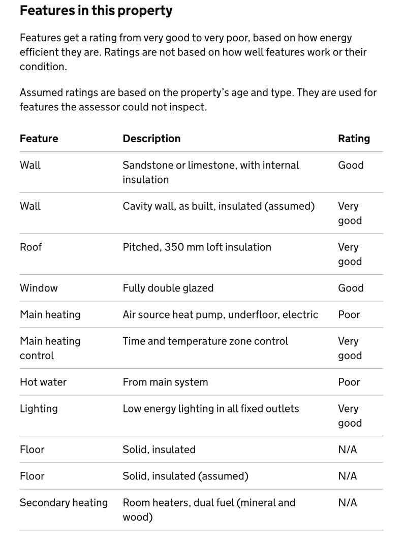

Here's the EPC printout to illustrate the point I made in a post last week. Sorry to keep banging on about this - but it is bonkers.
On the left the property's ratings before a total renovation when it had storage heaters. (Overall G)
On the right the EPC rating of the features in my house after the heat pump was installed. (Overall D)
The overall EPC rating had improved but not, apparently, because of the heat pump.
I still can't get to the bottom of whether this is just a "feature" of the EPC algorithm or the assessor ticking a wrong box when entering the data about the property.
Screenshot 2025 10 05 at 18 23 11 Energy performance certificate (EPC) – Find an energy certificate – GOV.UK
Screenshot 2025 10 05 at 18 22 21 Energy performance certificate (EPC) – Find an energy certificate – GOV.UK
