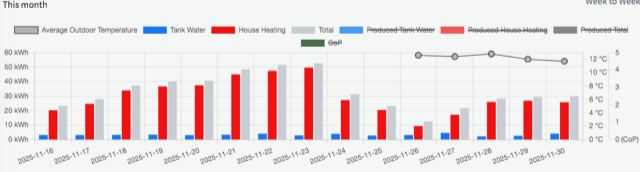

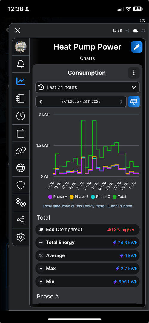

@hcas Hello Henri, I know that we have had an exchange on WhatsApp which was not conclusive and I don't find those exchanges all that satisfactory, because they require instant response rather than a considered one.
So backtracking I wonder if you could comment on one aspect, i.e. the apparent minimal response to a target temperature of 24C (increased from 23C) and seemingly stuck at 20.5.
In the previous location for the PAR 60 (the coldest room in the house, our bedroom) we seemed to be getting some improving results both on response and on COP. but since moving the PAR 60 into the adjacent room on 24th Nov (about 4m distance but with more reliable WiFi), the response has been much reduced. It may be that the daytime temperatures have been higher but the night time have been around the same and I have gone back to 24 hr operation to try to maintain bedroom temperatures.
Could you explain why there is currently so little apparent response to a difference of 3.5degrees C between actual and target temperature?
(I did wonder if the PAR 60 was reading low but it is backed up with a Shelly H & T which is nowreading 20.8C
To be fair, since increasing the target temperature to 24C earlier this evening I do see a reaction as below, but it still looks lower than I would have expected.

On the problem at hand, the root cause is that the machine learning models fail to calibrate well for your home. It comes down to the fact that the data doesn't show a clear pattern between room temperature, activity of the heat pump, and other data like outside temperature. If there are no patterns, Havenwise can't learn.
To make it very concrete: Since yesterday afternoon, the flow temperature has been continuously higher than 45C. And was actually 55C the whole night (benefiting from your cheap overnight tariff). Yet the room temperature is "stuck" at 20.5C. For similar outdoor temperatures yesterday, the heat pump ran less hard (flow temperatures 38-50C), yet the room temperature also stayed at 20.5C mostly.
If the models can't calibrate well, they can't accurately track your setpoint.
Btw, as you can see in the above explanation, it's not that the heat pump just sits idle. It runs at 45-55C flow temperatures with a deltaT of 7C, while the outdoor temperature is around 10C. So it's definitely putting in a good amount of heat.
I think we have to recognise that Havenwise might not be a good fit for your house. And perhaps the best path forward is to run your system without Havenwise.
I appreciate that's not optimal. It's also frustrating for us, and we haven't come across a situation like this. We've tried to solve it through various ways including manual calibration by our CTO, but I can't really see another option at this point.
