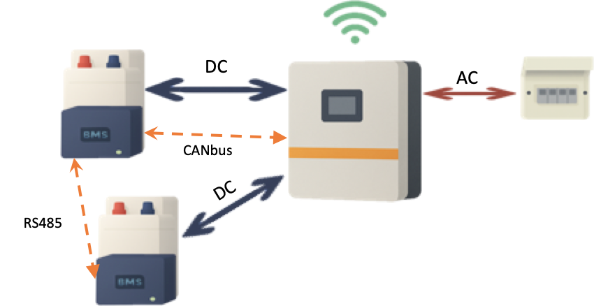

In the diagram below, I describe my understanding of the comms connections @bash described, which assumes that the BMSs on each battery can be made to work together (a basic way being that they are all the same SEPLOS model, with the same firmware installed).
My question is of course, why would the daisy chaining of BMS comms not work with other BMS models?
You've mixed software and hardware concepts within the same question, making it unanswerable.
Yes, you can have multiple BMS units connected to the same RS485 bus, with the Inverter acting as the Master.
Either the inverter must be able to support different Modbus variants simultaneously,
or else the BMS units would all need to be of the same type (eg from the same manufacturer).
You can't just make all the physical connections and then expect the inverter to sort it out for you!

Solis menus imply the inverter is only meant to work with one BMS from one battery manufacturer. And Seplos is not included (my third reason to want a different BMS).
I will ask Solis and post any answers in the Inverter thread
