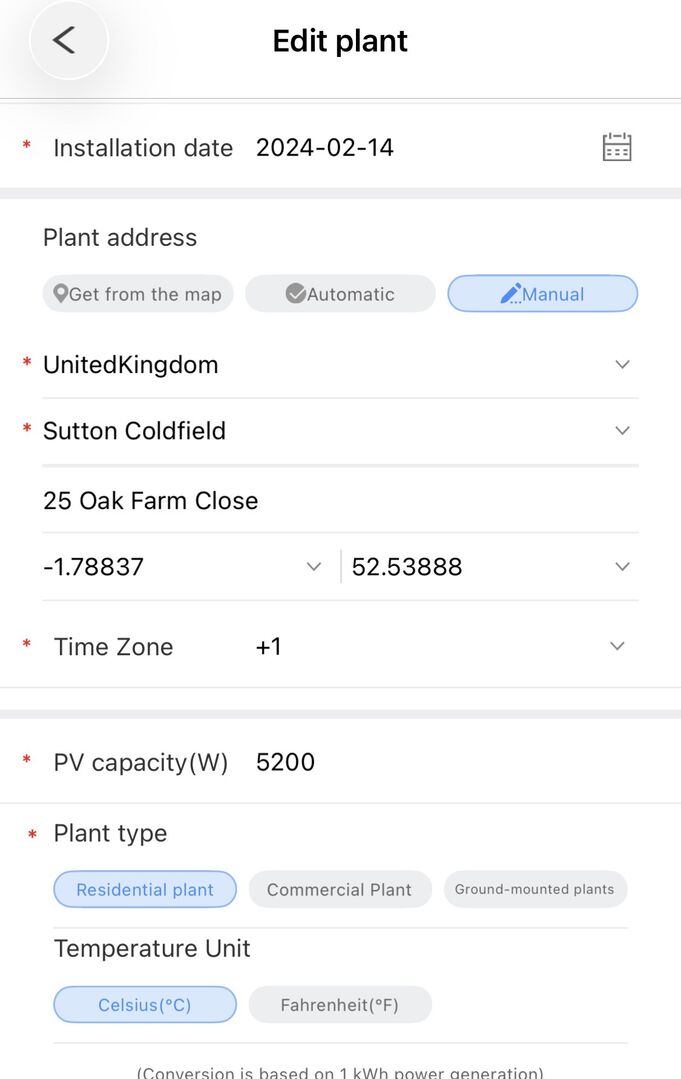

i was ferkling in the growatt App as i recalled i altered the inverter time differently last change, and eventually found the settings page below
To get the screen below, start on plant screen, tap on the address of the plant at the top
The Time Zone is set to +1, its a quick change to do, don’t need the password
Make sure the time is set correctly to GMT with time zone 0 before altering it to +1
IMG 8245
