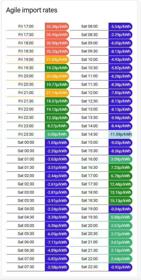

Posted by: @toodles
There are 30 plus HH’s tomorrow where Octopus Agile are eager to throw kWh’s to you and pay you to take them! Greeen Toodles (On Cosy).
You're not wrong, @toodles.
Octopus goes blue
Not only is that a lot of blue, 11.59p is a lot per kWh for them to be paying us to take their leccy.
