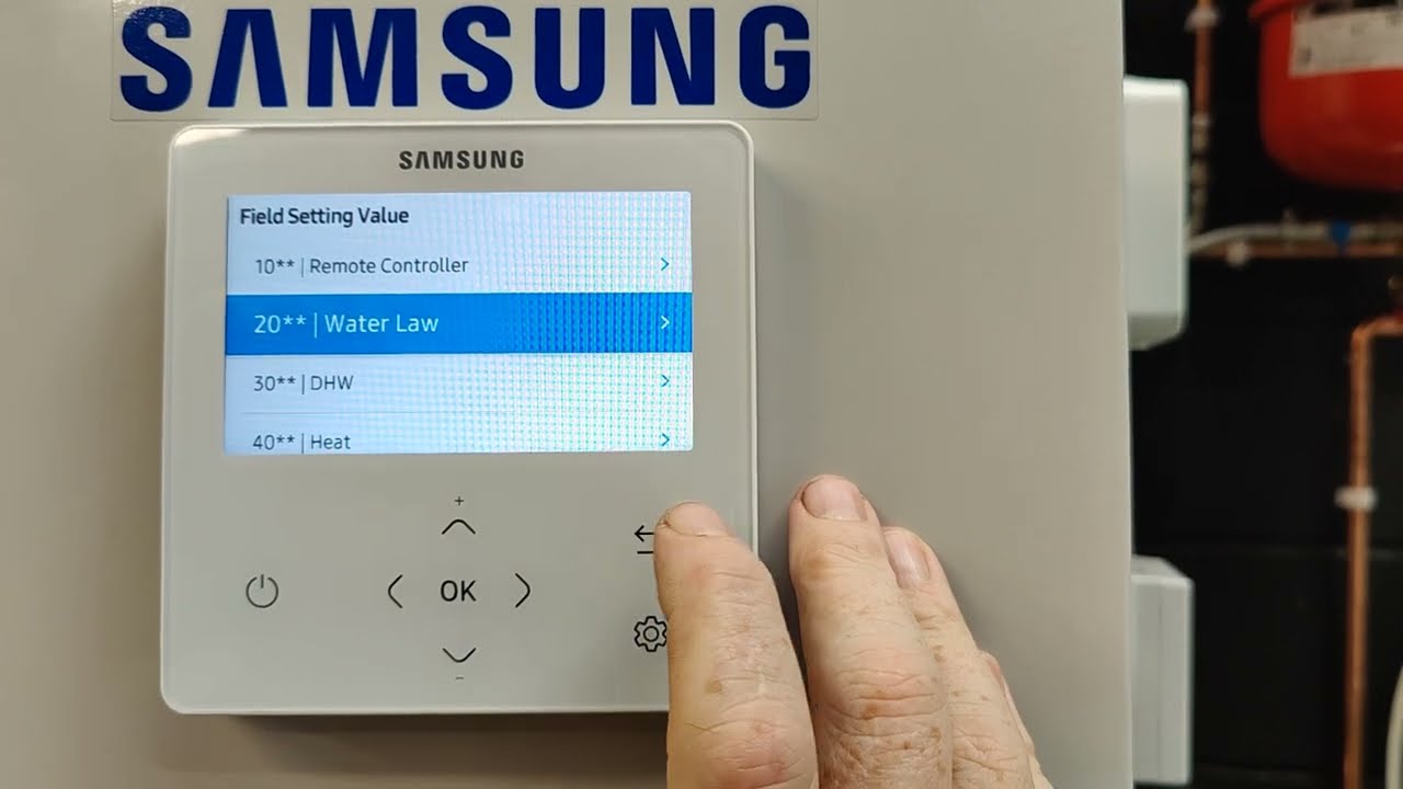

@pooneil This is how to alter the water law settings

Thanks for the video link. I've adjusted it to what he advised for a well insulated house. I'll check tomorrow to see if it makes any difference.
