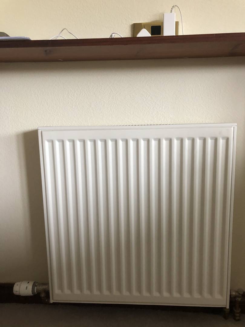

The 17kW to 11kW differential is significant. We have an 18kW pump that is heating around 4,000sqft (around 370sqm), so the 17kW may seem oversized, but then again the F EPC may have something to do with that. What radiators do you currently have and will be using doing forward?
@editor good to hear about Grant.Â
I’m  not sure what kind of radiators we have but this is what they look like. These are to be replaced by new radiators. Again I’m not sure what make. I will find out!Â

Lowering your heating demand would not only mean a smaller ASHP would probably be adequate, but should also operate more efficiently and be more cost effective to run. You may also be able to use some, if not all, of your existing radiators.
