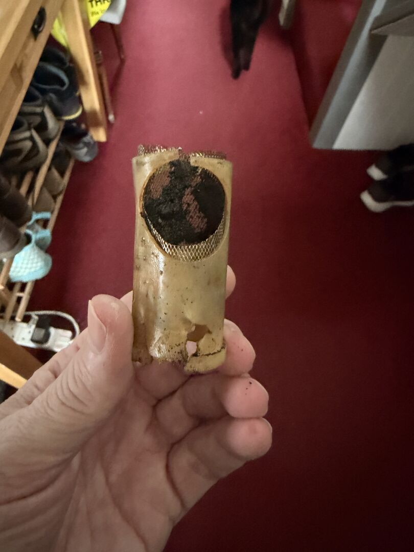

Well the hits keep coming! I had a sudden loss of flow from 28 l/min to barely nothing so had the installers back in. I genuinely don’t believe that they flushed the system when it was installed in Jan. They were supposed to put in all new pipework but as per ECO4 regulations they cut as many corners as they could and tied into old pipework (obvs!). I stuck some cleaner in the system and then did a poor mans mains flush then fully drained down the system while they were on their way. The mount of crap coming out of the system was ridiculous the mag filter had tons pf crap in it but the saving grace and the root cause was the filter just before the ashp between the external volumiser and the unit. It was totally blocked.
The installer trashed it getting it out as it was completely stuck in there, now bear in mind this was serviced by Grant in June. I have ordered a new filter and the system is running smoothly again but I am really getting hacked off with the repercussions of a crappy install!

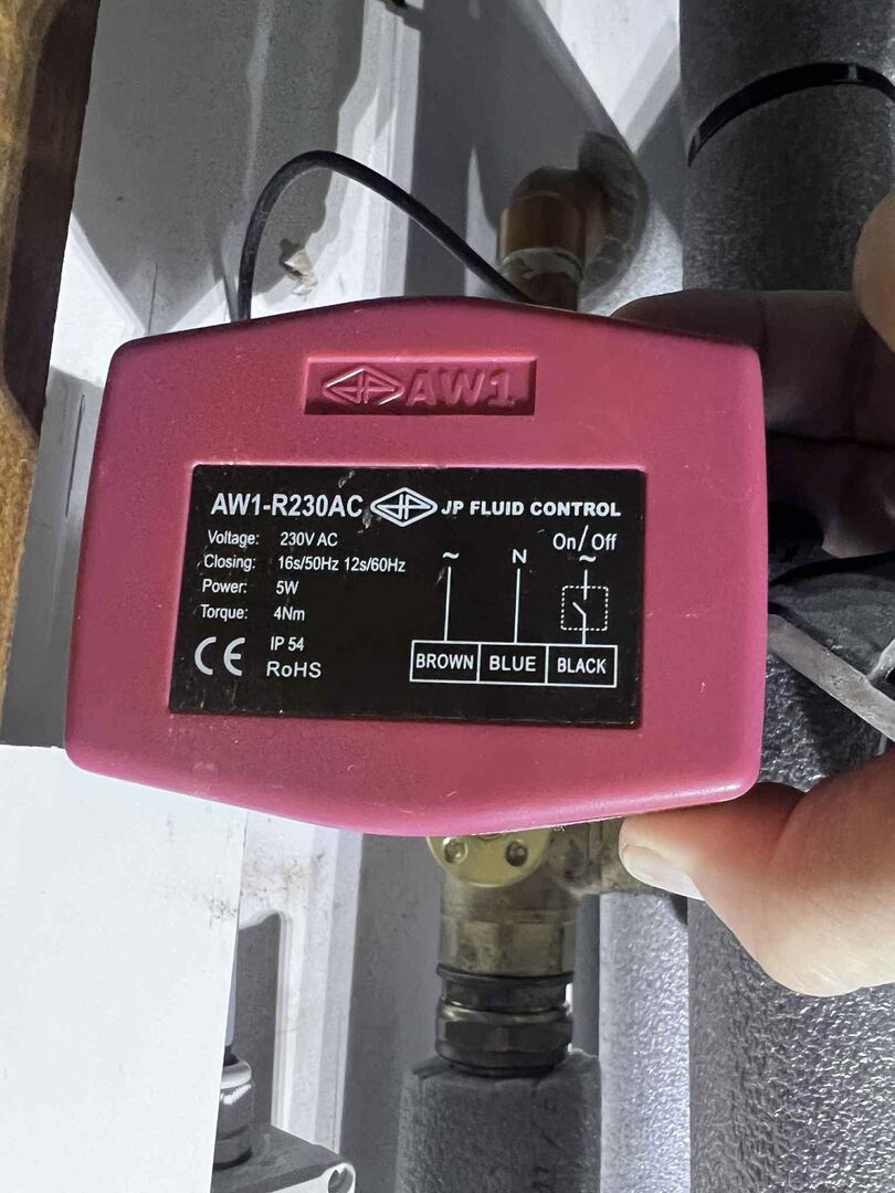

Now I really want to have a full system flush and I think that the honeywell 3 port diverter needs changing or at least removed and properly cleaned. I have been recommended the model below. Has anyone had any experience of them versus the honeywell as I am on my second honeywell already and the system isn’t even a year old

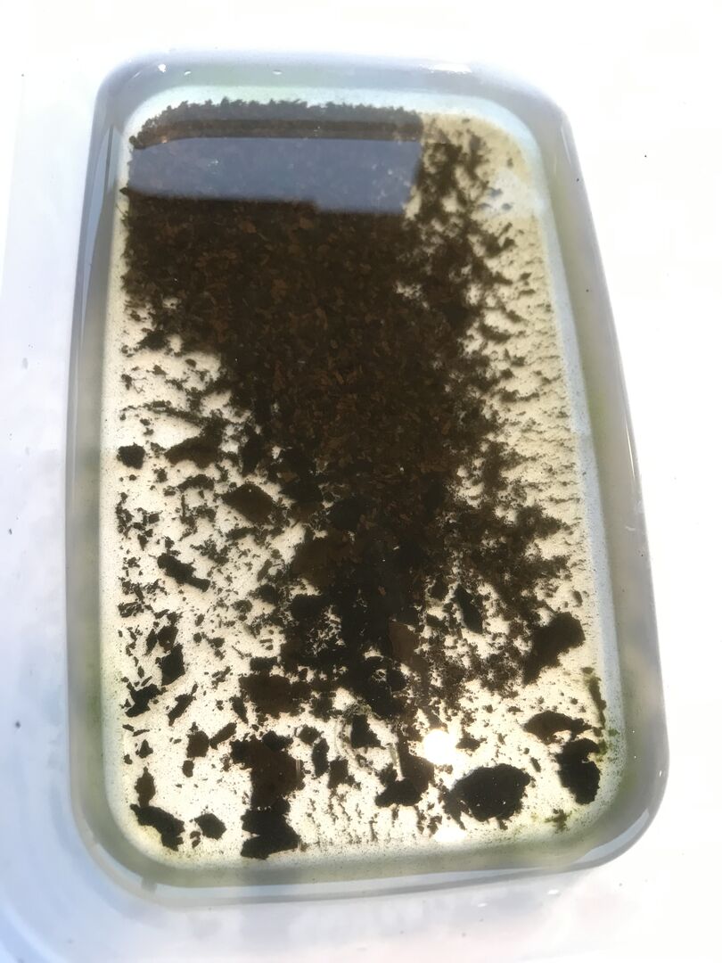

I decided to reverse flush the HP heat exchanger by removing the gauze filter, unscrewing the ‘return pipe’ filter nut and opening the valve - bringing water back through the Heat Exchanger at about 1 bar mains pressure. This also meant it wasn’t a full drain down.
The result was a mass of scale and fine particles. see pic below.
This was a short jet flush with only about 6 ltrs removed but has completely removed the problem.

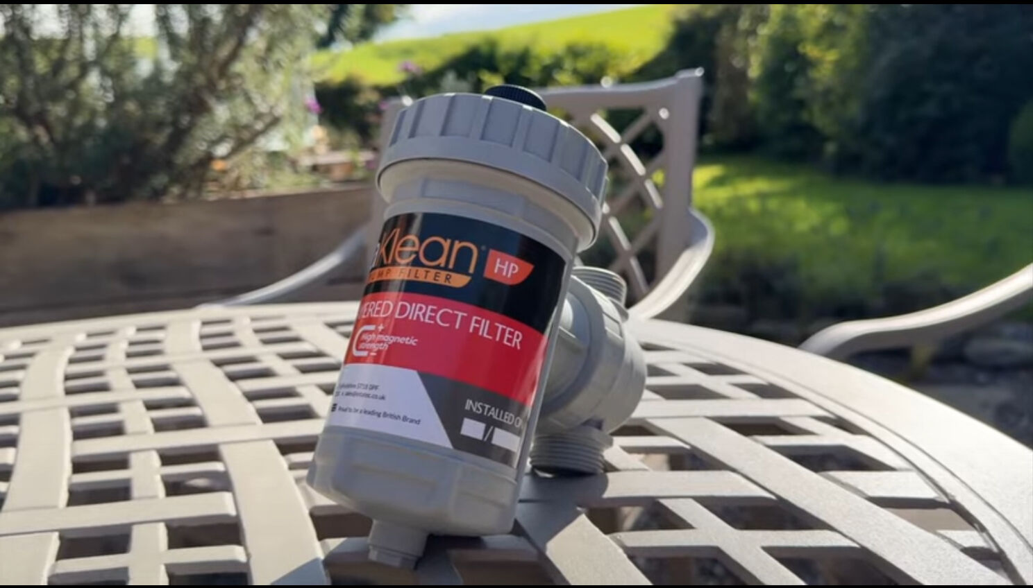

I also bought the filter seen in Mars’ video about a year ago. Which since all is working I haven’t fitted yet.
