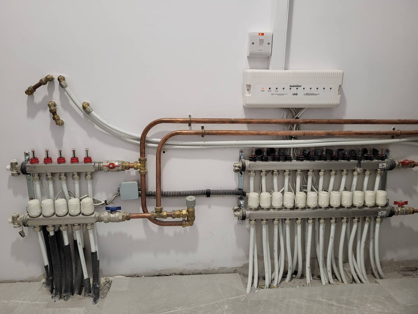

@newhouse87 I just looked at your photo, looks like you have 13 circuits, is this the only manifold in the house?, if so then you likely have 200mm centers for you UFH and likely close to 100m pipe per circuit, unless you have a lot of areas where there are not UFH pipes, e.g. where you have cabinets or other built in furniture/baths/showers etc.
This will likely limit the efficiency that you can achieve because with 200mm centers and quite long circuits you will need to run a higher temperature and likely quite a large deltaT
You really need the UFH diagrams, and the heat loss calculations to be able to get an optimal setup.
As mentioned before, you will also need to balance the system.

@william1066 have 2 manifolds, 17loops in total. Fairly sure it was 150mm spacing. How long should it take for lwt to get up temp, mine still at28 an hour in when desired temp is 37.

If you have 17 circuits, you must have a second manifold somewhere since I could only count 13 in your picture.  Let us assume for a moment you have 17 circuits.
For your floor area, the following is likely.
@200mm centers that means, on average, up to 70m pipe per circuit.
@150mm centers that means, on average, up to 95m pipe per circuit.
Both technically possible, though the second at the extremes of what is recommended.

Thats 2 manifolds,id imagine some loops run near100m, not all i hope. I ddnt post them 2 diagrams however. Why would my boiler have flow this morning when no call for heat or dhw, is that cycling? flow rate last night at 33 with 7 loops open.what do you mean run heating twice as long, the heating turns off when stats get up to 21 in living areas. 19.5 feels little chilly to sit in at night so try to have at 21. during coldest days i had house at 22 and was v nice but was using up to70kwhs a day when temps below freezing and, was that usage pretty normal so and i overreacted?

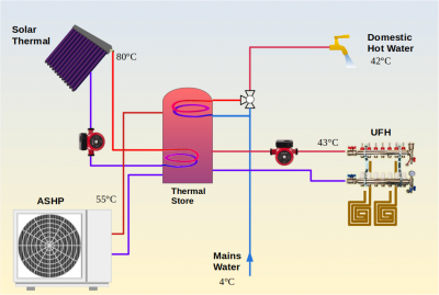

@newhouse87,
I'm not going to try and add to any of the technical advice you've had but ...
Up to 70kWh to heat a 240 m2 house to 22 deg at below zero outside temps is in the right ball park, even for a new house.  My house, although not new, is quite well insulated and about 2/3 the size of yours.  I heat the whole house to 21 deg and use 45kWh or so in similar conditions. You may be able to improve things a bit but I doubt you'll see drastic improvements. Definitely worth doing what you can though.
Posts: 3506
Your energy: 58 kWh
Posted by: @william1066
as you have radiant heat 19.5 should "feel like" 21 with radiators.
Posted by: @newhouse87
@newhouse87 this suggestion from @william1066 is due to
  • the way in which heat is transferred into the room
  • the way in which the human body perceives the 3 different categories of heat
As a lab-technician, you'll already know that heat can be transferred by conduction, convection and radiation.
A radiator heats the room primarily by convection (despite the name!). The cold air rises past the surface of the radiator, picks up heat, travels across the ceiling and then falls onto the occupants on the other side of the room. Thus the hotter air is high up, and the floor has a cold draught across it.
Convection
However, UFH transfers the heat mainly by radiation. The larger the mass of an object in the room, the more of that radiation is absorbed.
radiation
If the surface of a floor heated by UFH has reached a pleasant 25-26°C then a human will feel warm.
But the air temperature at your thermostat will be reading about 19°C.
To achieve the same result with a radiator requires an air temperature of around 21°C
Don't just look at a thermometer in the room. It has a relatively low mass compared with a human, and is measuring air temperature transferred to it by conduction from the air molecules.
Warning... pinning this up on the staff room wall will provoke furious debate.
Do so at your peril!
