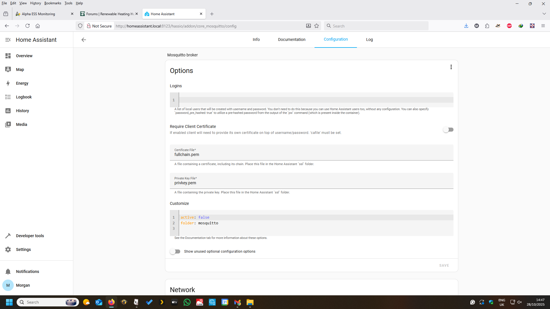

Screenshot (6)
@majordennisbloodnok
 6.   Now, switch to the Configuration tab and, under the top section (marked Logins), click Add.
No option to add.

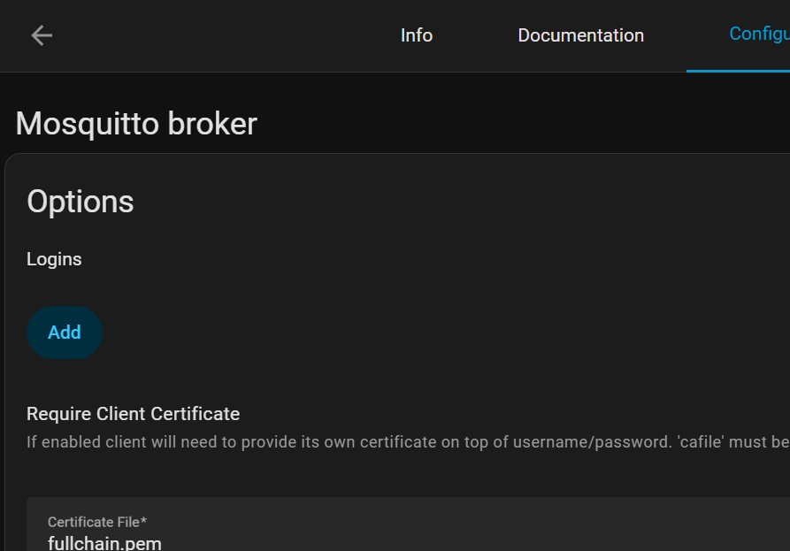

It looks like yours is accepting a list - it's worth noting that if you leave it blank, you can still use any existing Home Assistant users login details instead
My Home Assistant version shows "Add":

Actually, that's great. In that case:
  1. Go back to your left hand bar, down to the Settings cog and click on it.
  2. On the Settings page, click on People, then in the bottom right corner click on Add Person.
  3. In the ensuing dialogue box, give the new user a name (e.g. Mitsi) and click on "Allow person to login". This will reveal some extra boxes.
  4. Put the new user's password in both the "password" and "confirm password" boxes, turn on the button saying the user can only log in from local network and turn off the "administrator" button.
  5. Click Create to clear the dialogue box, revealing the other dialogue box behind.
  6. Click Add to clear that second dialogue box and you're done.
I'd forgotten that the MQTT broker these days allows you to set up users in Home Assistant without reconfiguring the broker itself. These steps should sort that out.
