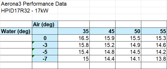

A reminder - 1840s 300m2 vicarage - no 3 phase possible - 16.9kW heat loss - new extension with UFH - PHE/bronze pump on the old Joule 300ltr - fam of 4, 2 teens.
My new plan was the 17kW Grant Aerona supplemented by a 4 kW or 7kW Slim Jim electric boiler (dialled down) as a (hopefully) unused back up and try to wrangle the BUS on the basis that it was just that - a back up. Going this route on the basis that no one seems to really know how an old house and an ASHP is going to work until you've tried (!) and for c £550 it seems a good insurance policy (and will reassure my wife).
At this stage we want to stick with the 13 rads we have and change them over time (but also see how the system works effectively bolted on to what's here already - and yes we'll initially need to run at 50/55 degs I'm guessing). Many of the rads are newish cast iron, 4 upstairs are never used and we'll increasingly use the new kitchen extension.
Shoot me down and tell me what I should really be doing!....
The Aerona stats are below:

Then presumably I need the installer to redo our heat loss estimate to fit with the Grant at -1.88 degs (approx 14.9 at 55 degs) ensure SCOP of 2.8 and then I can claim BUS....or not and keep the SlimJim as a hopefully unused back up...

Im presuming you are looking at the R32 model on the basis that their website doesn't list a 17kW R290. FWIW this is the Chofu heat pump badge engineered, sometimes people have found (useful) things in the Chofu manual that aren't in the Grant manual, but that may have changed.

thanks guys - I hear you on the not rushing and plainly we need to sort this heat loss, which is crucial (obvs) but also a bit like nailing jelly to the proverbial ceiling reading through contributors' posts.
It matters to us because we're on the tipping point between single 17kW or the dreaded 2 x 10kW, but will we REALLY know until we actually do it and run it? I am tempted to buy a SlimJim for the winter (say the 10kW) and run it at different temps through the winter and see how we fare. As previously mentioned we do have 3 wood burners as well in the mix.
Would this SlimJim idea work (and how would it work with the UFH at 35 degs and rads at (say) 50?)??
And would running 2 x 10kW be very much more expensive than a single 17kW (we spend £2500-2800 annually on oil).

Honestly I doubt, based on your oil consumption** you are on the tipping point between 17kW and 2*10kW, much more likely you are on the tipping point between 17kW and 12-14kW. However only a real measurement will tell for certain.
An electric heater will work of course, correctly plumbed, just bear in mind the running cost. If you want two different temps you must have a mixer, thats true whatever the heating as there is no boiler or ASHP available that can output 2 flow temps at the same time!. An electric heater is also a fantastic way (frankly the best way) to determine your heat loss assuming you have a smart meter and can get half hourly meter readings. You wound need to take into account your log burners of course (you might have to weigh the logs you burn each day for a couple of weeks), but with the right 'experiment' its the most accurate determination available. Even the best survey is partly speculation!
Posted by: @guydebAnd would running 2 x 10kW be very much more expensive than a single 17kW (we spend £2500-2800 annually on oil).
Correctly set up and controlled almost certainly cheaper to run than a single unit, because you will get much better modulation depth. You could, with the right plumbing, play lots of games, eg arranging them to supply two separate flow temps simultaneously, arranging so that one is a fall back when one fails. Its actually a jolly flexible system BUT makes plumbing and control more challenging, so needs a sound installer and a make/model that has flexible control for cascades. That said for the 4K or less that the additional unit costs its a pretty fail safe way to go
