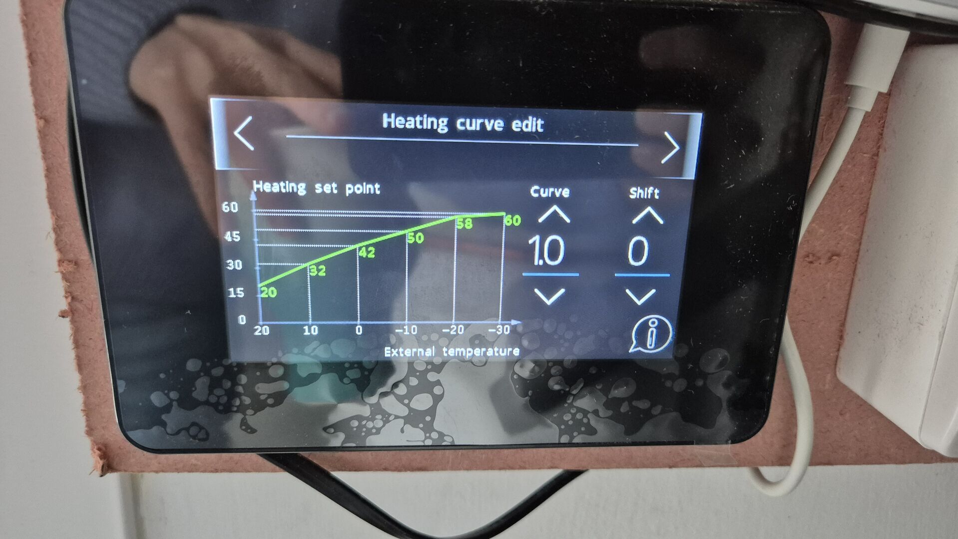

I managed to find the heat curve in the installation controller and reduced the curve to 1.0 from 1.2
heat curve 160126

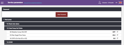

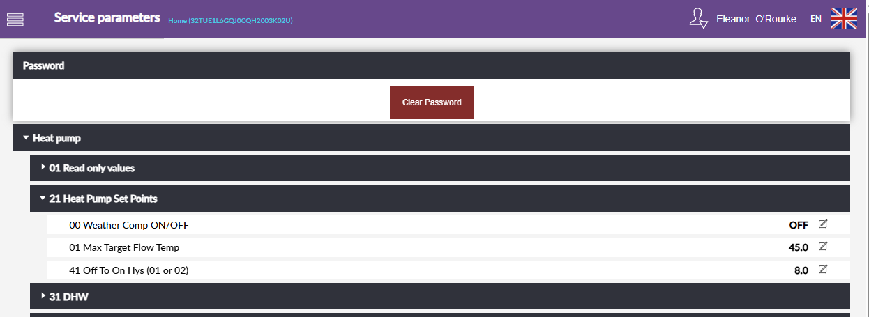

I have also noticed that the weather compensation is off under the service parameters. When I change it to ON it just flicks back off.

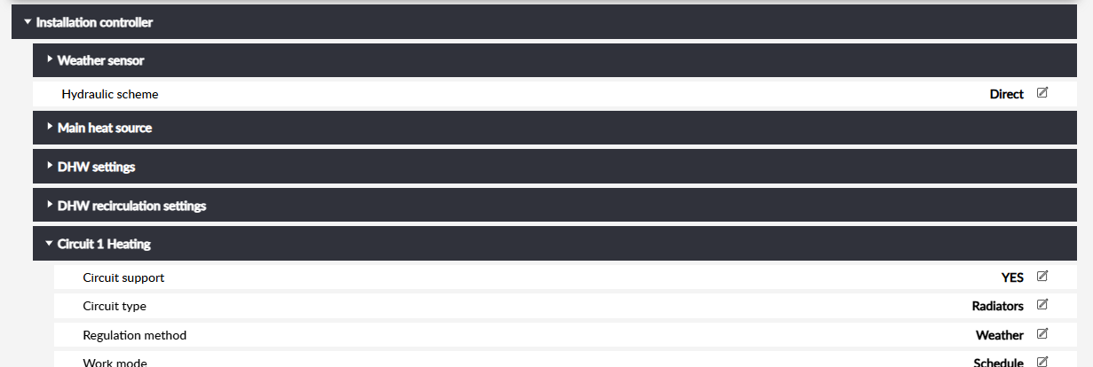

However in the other service parameters menu there is a WEATHER enabled under installation controller and the "C1 - calculated set temp" does vary with the outside temperature e.g., only 33.2 C today at 9.5c outside compared to over 40C when it was much colder last week.

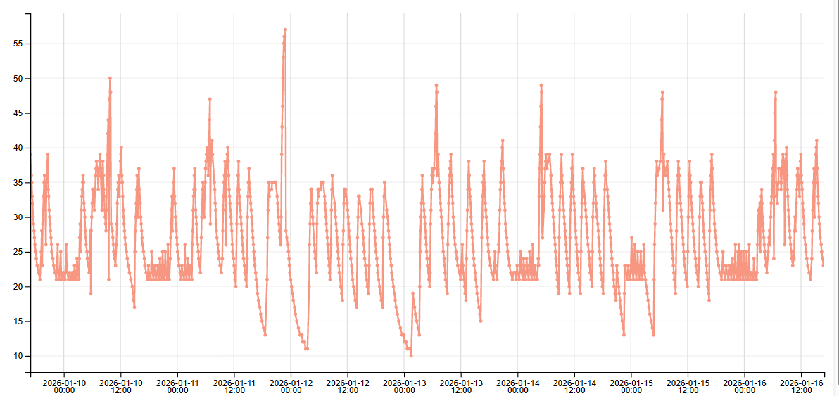

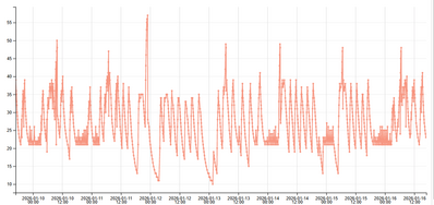

I have the day mode set at 18.5C and night set back at 17C (21:00-05:00). It does seem to be operating like my gas boiler did (I had it on constant 18C all day), on until hits the temp then off until drop below the day (see outlet temperature graph below) - hysteresis value (0.4C) rather than steady so I am keen to get to the low and steady but should I drop the heat curve or the shift when attempting that?

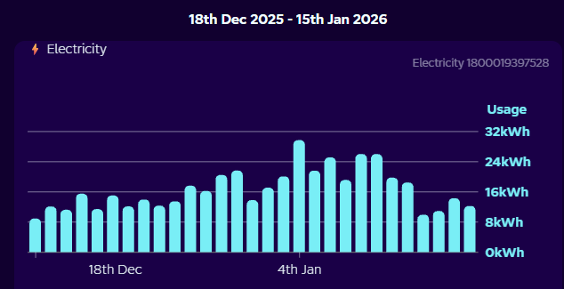

I am likely being dim but I cannot find the energy consumption information or COP in the ecoNET app or on the Grant Aerona Smart Controller. Can anyone point me in the right direction? Below is my Octopus energy use (non-heating is usually 3-6 kWh per day)
