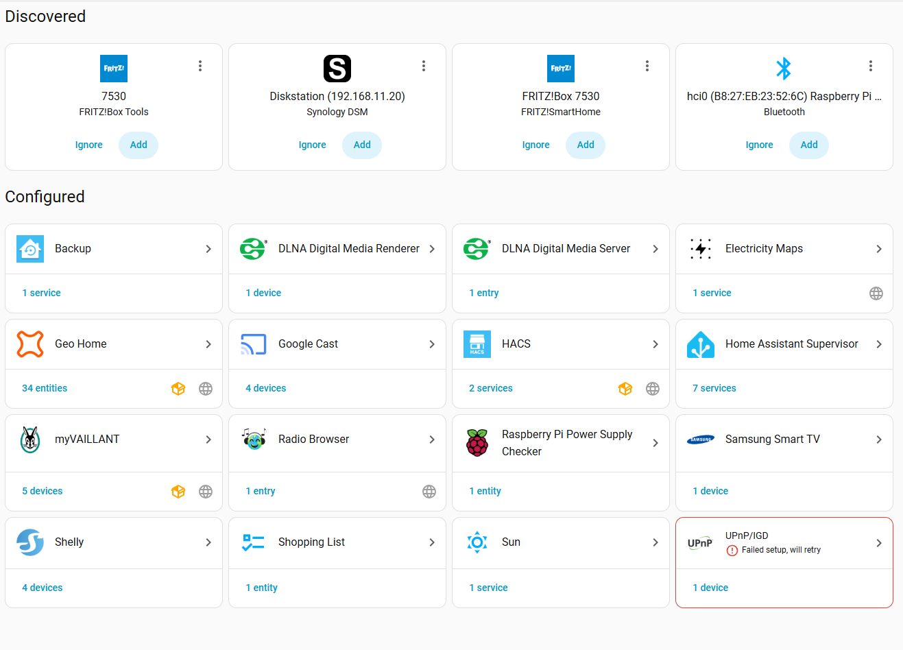

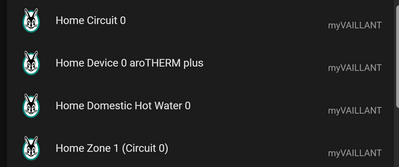

OK so the integration is installed. Good. Via a web browser is the way to access it.
If you go instead to settings - devices and services you should see a screen like this (you will have different devices and services, but should have the Vaillant one

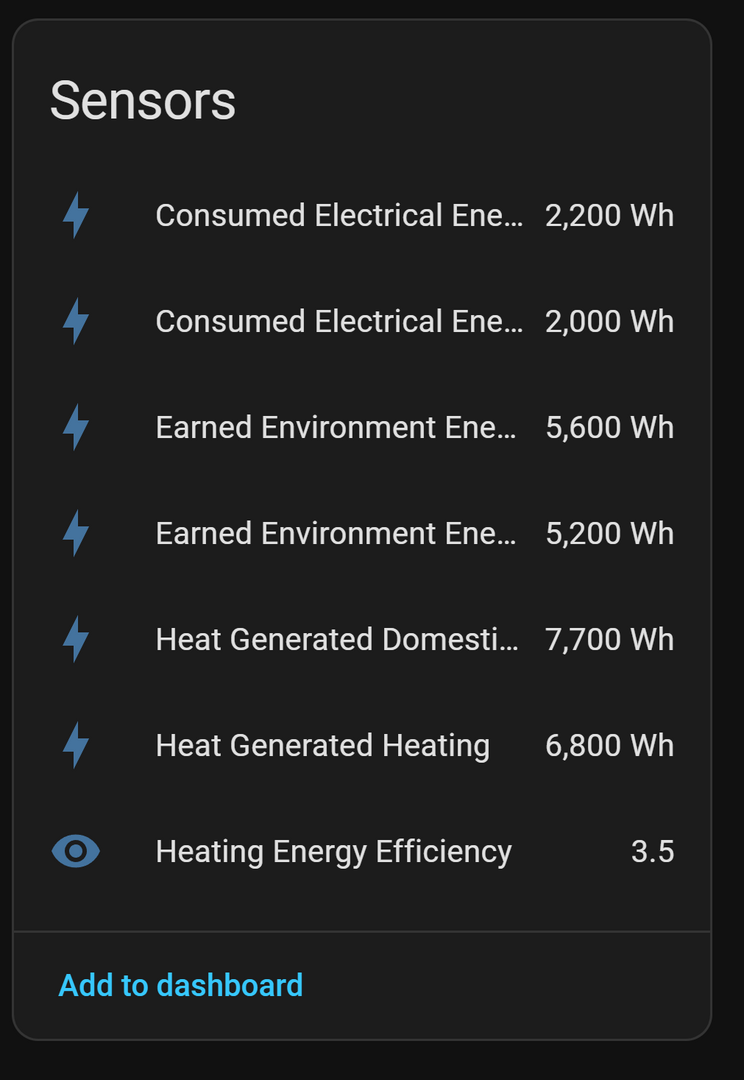

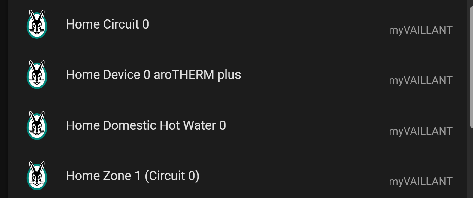

Click on myVaillant, you should see 4-5 lines each describing a 'device', like the screen you posted above. If you click on any of them you will see loads of tiles each of which has a link 'add to dashboard', something like this
You can add tiles to the dashboard using this, then once you have done that clicking in various obvious places pulls up further options.

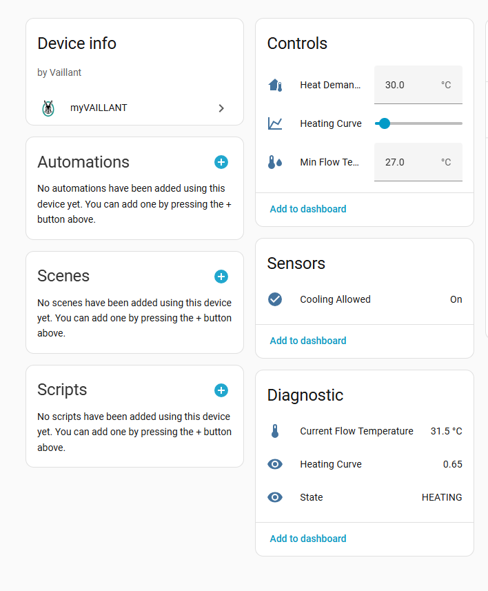

Good start, click on add to dashboard.
Then go back to previous list from settings - devices and services and click on circuit 1 you will get some more sensors. You can repeat with the other devices until you find the sensors you want

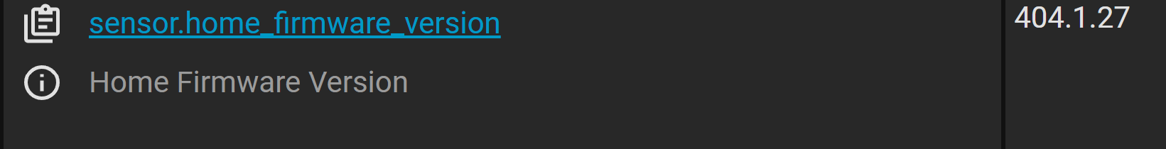

if i go into developer tools and states then scroll down i can see it but its listed in the firmware version section.

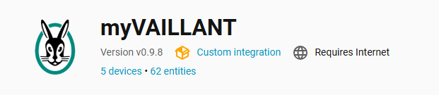

I have the same firmware. I have MyVaillant version HA integration v0.9.8. The Power consumption sensor is a fairly recent addition.
What I dont understand is why you HA setup look quite different.
