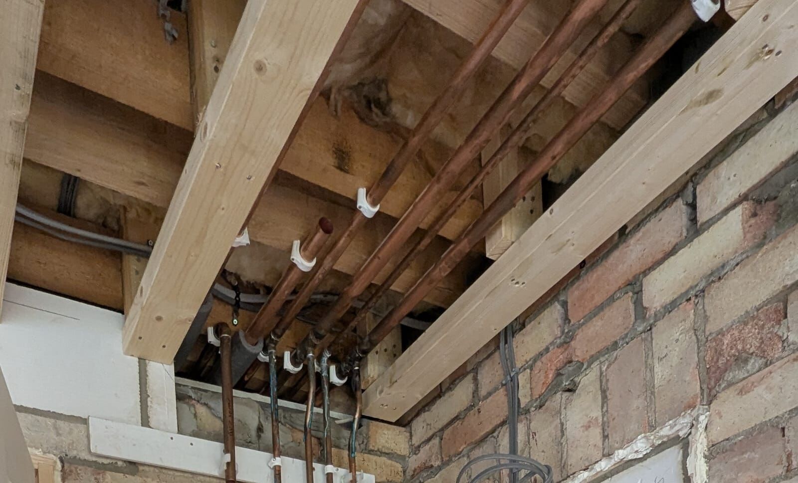

@jamespa installer said today "Yeah unfortunately thay is not going to help with vibration. They aren't anti vibration clips and/or the pipes been wrapped or insulated." after seeing part of the 28mm runs that i could find in my photo's, i have since explained that the pipes are insulated and this pic just shows part of the run of 28mm that wasnt yet finished.
Posted by: @adamkthis pic just shows part of the run of 28mm that wasnt yet finished.
yes but they are presumably insulated over the clips (unless you removed the clips and refixed them before insulating) so are hard against the rafters.
Could be transmitting noise indoors.
Whats the next step or have you accepted it as it is?
Posted by: @adamk@jamespa if I remember the insulation has a notch cut in it so it goes over the pipe and either side of the joist.
But presumably leaving the clips, visible in the photo, in place this providing the opportunity for vibration transfer
@jamespa yes I guess. But surely not everyone is buying special anti vibration clips? My plumber (who has worked on large scale renewable stuff in a previous job) didn’t suggest them.
today during its eco hw run I had a listen and found even in this mode some noise in the utility which is 4m away, could feel it ever so slightly by touching the ceiling where the pipes are. Also found if I put my ear to the French door double glazed unit, that’s about 1m away from the outside hp, it was rather noisy bit like the sound you get when running a tap that’s got narrow internals.
flow rate is 750. So about right.
Posted by: @adamkBut surely not everyone is buying special anti vibration clips? My plumber (who has worked on large scale renewable stuff in a previous job) didn’t suggest them.
I'm sure you are right, I was just trying to understand what you had. That said I'm pretty sure most if not all of the 5m or so of 28mm primary I have is clipped around the insulation this isolating it, I guess a feature of it being a retrofit.
