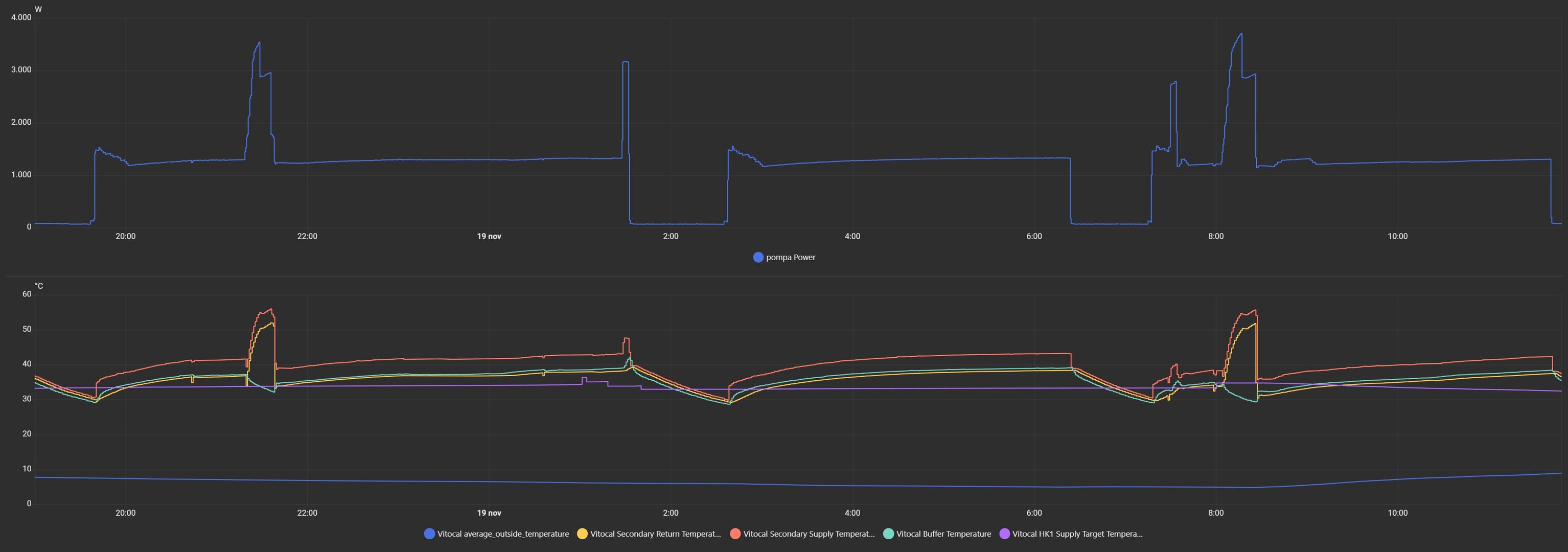

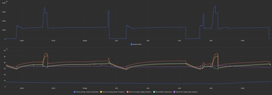

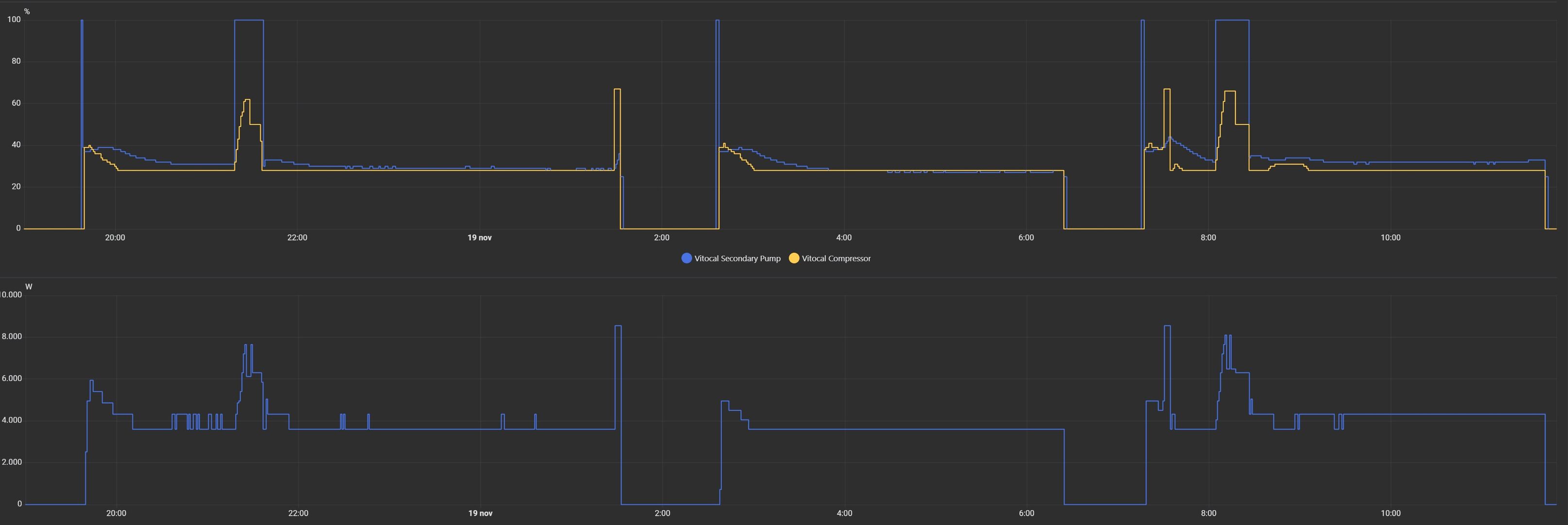

After years of trial and error and research I understood the logic behind my veissman HP, and I can change almost all parameters. This model unfortunately is oversized for my house, it's a nominal 8kw but it's more like a 12kw, meaning that the minimum heat it can generate it's around 4kwh. regarding the logic, basically the whole heating cycle is based on the buffer temperature. The heatpump heats the water to bring it to the target (set by weather comp) and it can increase that temperature based on a tolerance that I can change, after many tests I set it to 4 degrees up or down. This way I drastically reduced the on/off as you can see from the graphs, unfortunatly this setup I think it's not great for efficency (no buffer would be better) but I can't do it differently because of the dual circuit. So In a situation like the graphs attached, the heatpump is constantly running at it's minimum which is 25hz or 28% capacity, and it can run for hours.

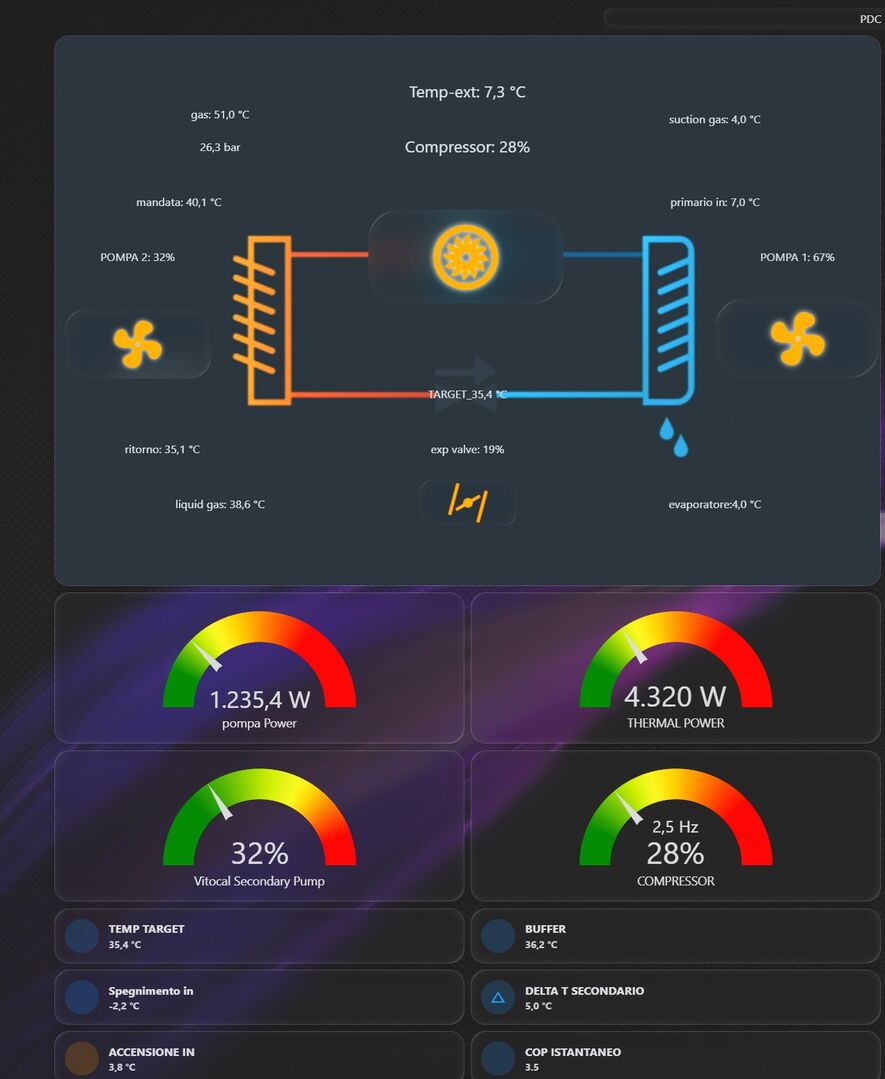

The delta T in this cased is calculated by the heat pump that regulates it's secondary pump to the buffer to mantain 5K spread constantly. The problem I have is that the COP is pretty low, as you can see. My data is based on Thermal energy (from heatpump data), electrical energy (shelly em that measures also the 2 pumps on the buffer). I can also see the heat pump's COP as a datapoint and of course that one is higher. Last night it was around 4-6C and the cop was under 3. Am I just unlucky that my model has low efficency? I know that lowering supply temperature will of course increase COP, but I feel there is more to it. Any idea is appreciated . Sorry for my english as it isn't my first language.

Hi, and welcome to the forum.
I cant quite understand whats going on in the charts because the labels arent obvious.
Cn you clarify which of the lines shows:
Temperature of the water exiting the heat pump flowing to the buffer
Temperature of the water exiting the buffer flowing to the emitters
Temperature of the water returning to the buffer from the emitters
It looks like with an outside temp of ~7 you are running at a flow temp (I cant tell whether measured at the heat pump or at the output of the buffer) of ~40.  Is that a correct interpretation?  Can you tell me what your weather compensation parameters are please?

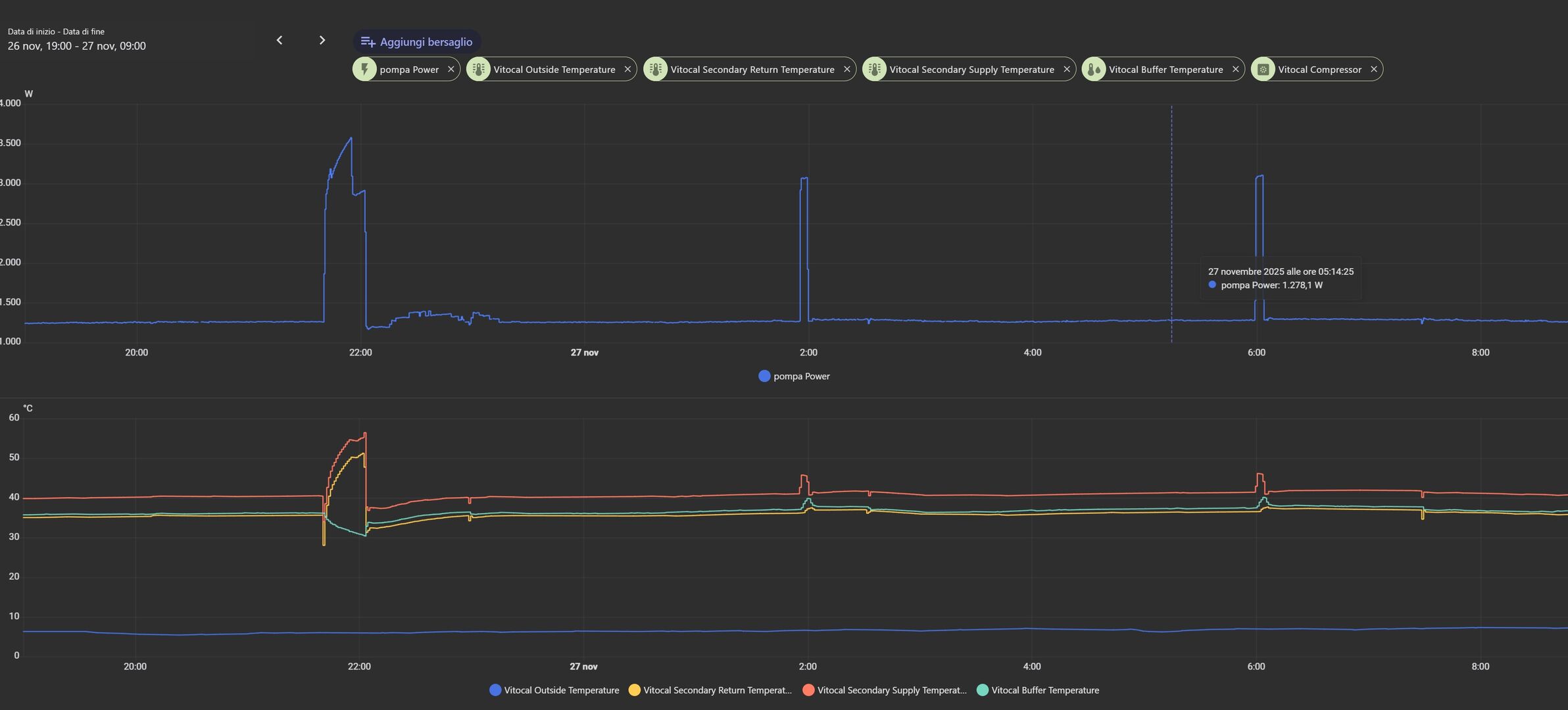

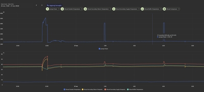

@jamespa Sorry for the late reply, I apologize for the graphs not clear. you are correct, so for example for the past 12hrs or so exterior temperature was between 5 and 7 C, the heatpump maintains a constant delta 5 between what it prduces and the return, and it never stops, it runs at the minimum of 25hz which is 28% of the compressor, and it delivers 4.3 KW of thermal energy (according to the data it spits out), it produces water around 40C and I will say that it can't run any better. I have a shelly that measures the electric consumption of heatpump with all the pumps, including 2 wilo pumps that serve 2 circuits at the same temperature (radiators+fancoils), IF I calculate the COP using this data en the heat generated (data from hetpump), I average a cop of 3.4. The heatpump itself says 4.3 because it doesn't count any pump but only the compressor (that's what veissman says). I'm planning to replace some radiators next year so I can reduce the supply temperature, I'll probably have more on/off but I don't see anything else I can try. my next step is to measure the delta after the buffer to see if I can improve on that side, right now both pumps run at minimum speed. you can see from the new graphs the behaviour. The big "bumps" in the graphs are Hot water preparation, not sure about the small bumps but I don't think it's defrost. to read the charts, blue line in the first graph is power consumption for the whole system (shelly em ), red is supply temperature, yellow return temperature, green buffer temperature, blue in second graph is outside air temperature
