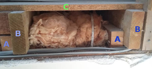

Let me end with a photograph showing 'loft flooring' which has been done properly:
LoftInsulatn2
A shows the original ceiling joists.
The span length is 4.6m, so these old 3-inch deep timbers aren't capable of taking the new floor.
B are the new floor joists which have been placed alongside the ceiling joists.
That leaves plenty of space below the new chipboard floor (C) for insulation,
and the re-routing of power cables (2.5mm² and larger) above the insulation layer.
