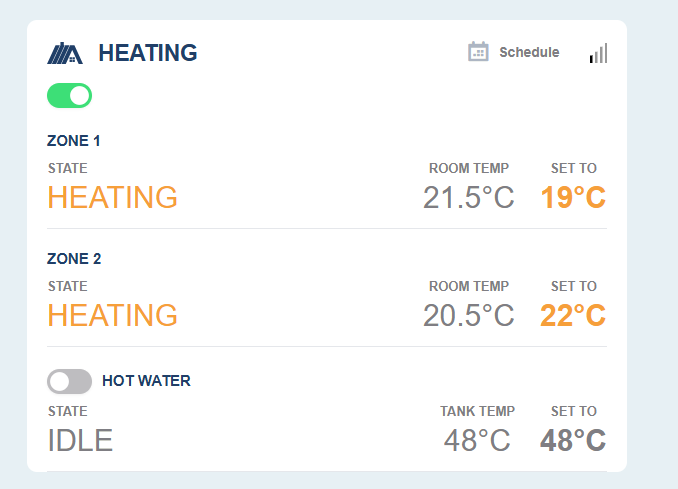

It's been a confusing start, when we first had the house, no matter how high we had the setpoint on the downstairs RC, no heat in the rads. Turned out that the RC downstairs was controlling the upstairs zone so it was 24c upstairs by the time we went to bed. We had the installers out to fix that.
Currently
RC1 is set for Zone 1 temp and Zone 1 Programme
RC2 is set for Zone 2 temp and Zone 2 Programme
The thing that is confusing me and it's probably a perception thing. RC1 is upstairs and RC2 is downstairs.
Picture from Melcloud home (I had no choice when I registered my equipment, Melcloud couldn't find the big white unit so I had to use MCHome ) I don't think this helps the perception.
