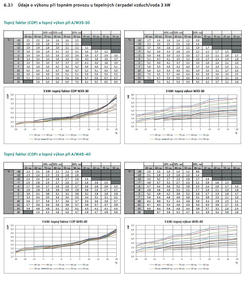

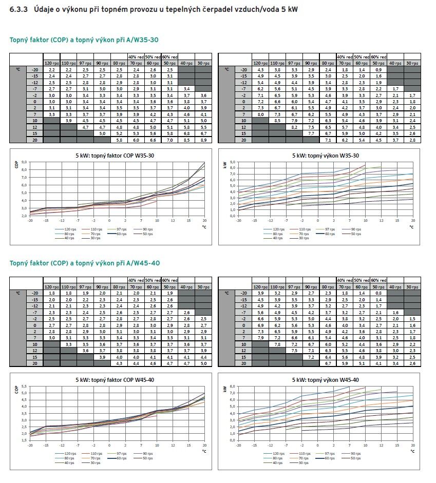

Here are the performance curves for the 3 and 5kW machines.  Sorry they are in Czech, these tables dont seem to appear on the UK website.  Note that
the 3kW max compressor frequency is 85rps whereas the 5kW is 120 rps
the performance figures at any given compressor frequency/OAT combination are the same
showing that the 3kW is in fact just a software limited 5kW.  The separate spec sheet shows they have the same compressors with the same refrigerant charge, further confirmation they are the same beast.
There is no reason therefore to prefer the 3kW over the 5kW, if anything the opposite applies (again in favour of SH).
Screenshot 2025 04 26 091318
Screenshot 2025 04 26 091336
Both models maintain a good COP down to low compressor frequencies, which is important for you because you will often be running towards the low end.  At these frequencies my 7kW Vaillant is very nearly silent.
Hope that and the above gives you more confidence.
