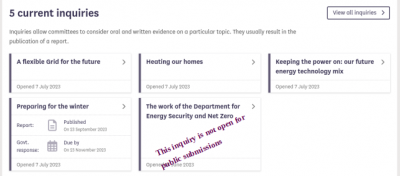

1: The inability of MCS to enforce its membership to implement the regulations is a generic problem.
2: What has happened in your case also breaches Part-L of the Building Regulations.
Those are two issues which result in others not now wanting to install a heat-pump in their own house.
The inefficiencies result in the home requiring more energy than it should.
Which is why the government misses its targets:
Â
The House of Commons Committee on Energy Security and Net Zero need to receive that evidence....
... not specifically about your site because that will come across as an 'individual complaint' and not be acceptable as evidence.
But they do need to know that MCS are allowing members who have been struck off to re-apply...
... and that there are houses being left with equipment which is incorrectly specified and installed.
They need photographs, diagrams etc which demonstrate the 'state of the market'.
They should be made aware of the different levels of incompetence which prevent GB from reaching Net Zero.
The HoC DESNZ Committee have four current Inquiries open to the public, for which all are now past their date to receive evidence.
Â
It could be possible to circumvent that timing problem if the weight of evidence you can provide is strong.
The Committee's staff need to see that what you present is sufficiently important that its contents must be laid before the Committee and included in their final report.
The Heating our Homes Topic has not yet had any of its evidence published online.
So that leaves a better opportunity for you to file a submission.
Â
You can already read the submissions for the Flexible Grid Topic and see the sort of evidence which is being accepted.
Some documents from large companies are just bland text, often difficult to understand and saying very little. 😫Â
Whilst other documents from community groups, individuals and campaigners are better presented.
They are making clear points rather than just trying to pass comment on all aspects of the subject.
So, there's the challenge.
Would you be interested in creating a well-targeted submission which reveals to MPs in graphic detail why the present policies to get heat-pumps installed are falling short of their Net Zero targets?
