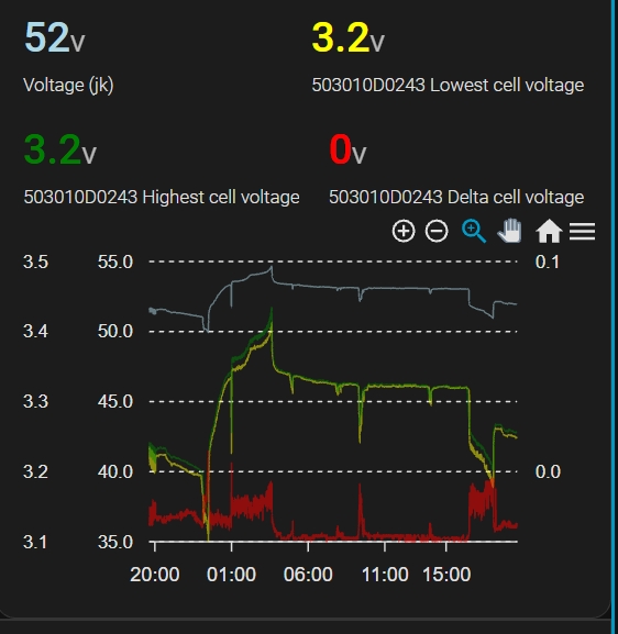

Posted by: @jancoldI have been trying to get my head around what this all means for the battery life? [...] Are there battery charge settings in the Solis box I could check? I have reduced the charge to 80A as that easily charges ( according to the Solis) the batteries in the cheap period and allows a time for them to sit before discharging to the house.

Posted by: @bashFrom my observations the Seplos V3 BMS that comes in the Fogstar Seplos units ramps down the charge rate as it approaches capacity.
My graph shows a straight red line when charging to 100%, so it is not doing that:

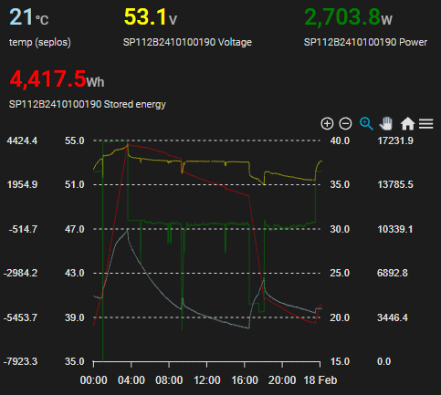

Posted by: @batpredBut for charging, I could just just break down the last charging slot with the one before the last having an soc lower than 100 and the last with a very low amp level like 40 and soc 100.
I do a lot of monitoring on this issue, and I'll suggest that 40A is still too high to bring the cells up to the intended capacity.
The reported SoC will be erroneous due to the voltage rise of driving 40A into the battery.
I currently decrease the charge current at 1-minute intervals down to no more than 5A (per battery).
Posted by: @transparentI currently decrease the charge current at 1-minute intervals down to no more than 5A (per battery).
