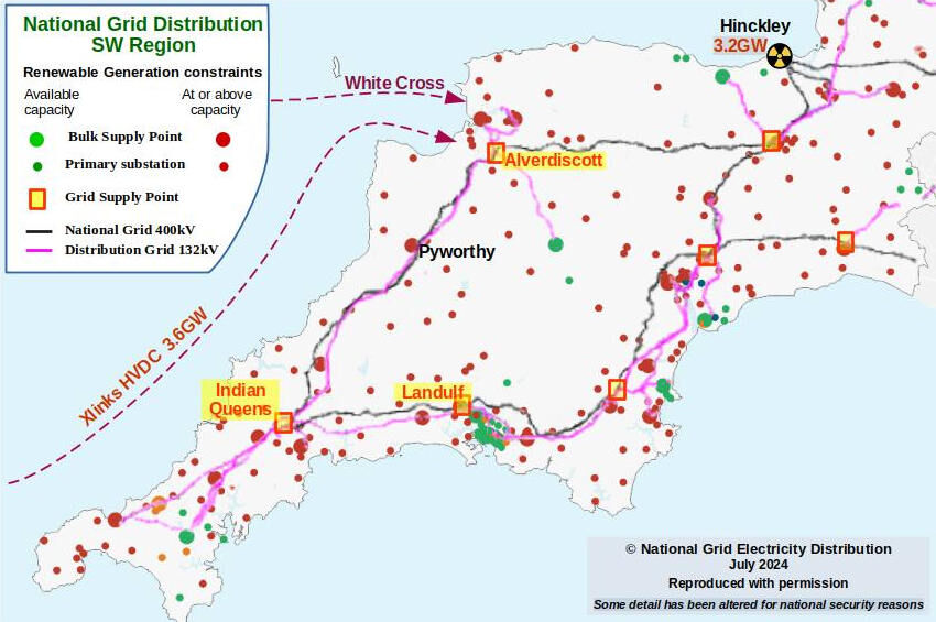

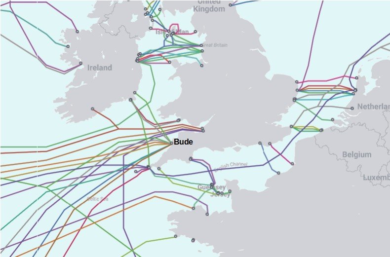

Have a look at these two maps:
The first shows the submarine data cables landing-points.
25% of global internet traffic passes through Bude in NE Cornwall
The second map shows the location of Alverdiscott, which is the most over-saturated Grid Supply Point in England,
and Pyworthy BSP, which has the greatest capacity constraints on the 132kV (top) level of the Distribution grid.
Capacity July24 Pyworthy
Both of these locations are in the high-rainfall zone, where the SW prevailing wind off the Atlantic meets
the rising ground of Dartmoor and Exmoor.
There's loads of 'free' water for cooling!
This is a situation when NESO and the Regional Energy Strategic Plan (RESP) organisation for the area should be making the decisions...
... rather than the Chancellor of the Exchequer!
To embrace technological advancement, UK PLC needs to evaluate its assets in scientific measurements (Joules and Terabytes)
not Pounds Sterling.

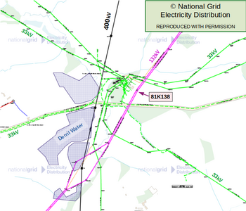

Derril Water is a particular problem because it connects to the 33kV level at Pyworthy Bulk Supply Point (BSP),
along with the other seven solar parks which have spawned around transmission tower 81K138 on the 132kV double circuit.
DerrilWaterSolar
The 400kV Transmission grid used to run down to Indian Queens near Truro and supplied all of Cornwall.
Of course, most of the flow is now in the other direction due to the quantity of wind & solar generation in Kernow.
The 132kV runs parallel to the Transmission Grid, and was intended to act as the fall-back.
In the event of an outage on the 400kV run, or for maintenance work, its double-circuit would allow Cornwall and the western half of Devon to still receive electricity.
Pyworthy BSP was the main connection point for all the NW quarter of Devon.
From there the 33kV overhead wires supplied the Primary substations in the rural market towns.
Unfortunately, Pyworthy has become a magnet for all the "let's make some dosh" part of the commercial solar sector.
I've shown only half of the Derril Water solar farm in the map above.
The rest of it is just off the map to the west.

I'll suggest that the best location for data centres in UK is where there is not only surplus electricity generation,
but also plenty of data. 😀

one point worth bearing in mind is that many of the transatlantic data connections terminate in Cornwall.
It's not just the transatlantic ones either,
but also the Africa West Coast route and the Europe-India Gateway.
Any other country with those precious resources would be actively utilising them.
A high proportion of data being processed in the City of London, already ends up being routed through Devon and Cornwall.
It doesn't matter where are are on the fibre-optic cables, provided you also have sufficient electricity to operate.
