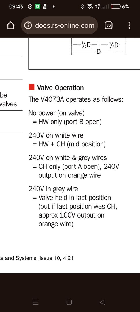

@bontwoody "but after a minute the 3 way valved closed."
I might be wrong but could it be a 3 port, 2 way valve with mid-position?
Screenshot 2025 10 21 09 44 33 87 40deb401b9ffe8e1df2f1cc5ba480b12
Operation by the following voltages

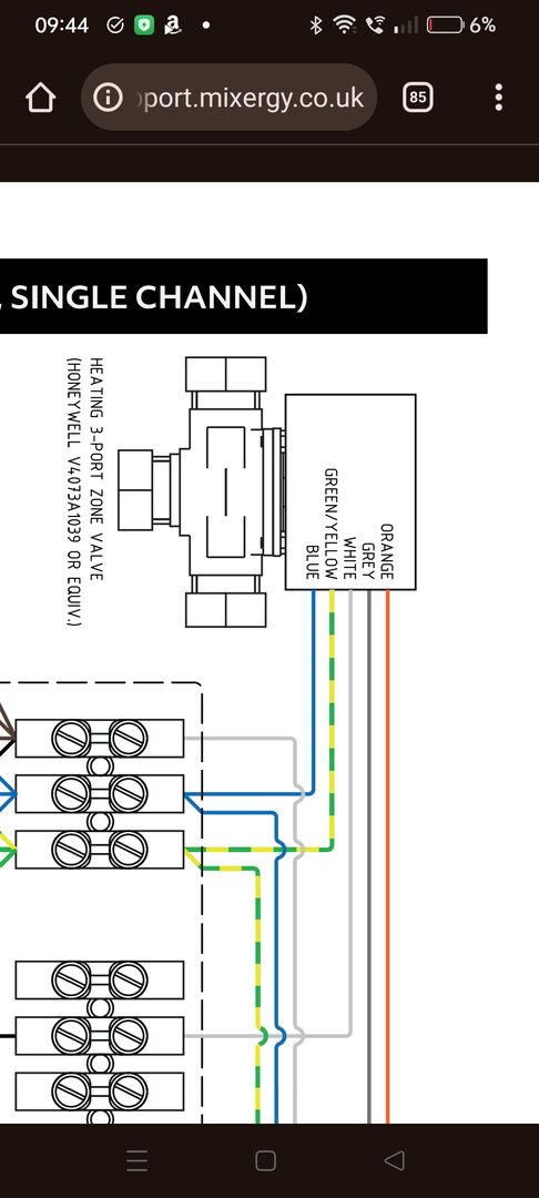

Screenshot 2025 10 21 09 43 24 90 40deb401b9ffe8e1df2f1cc5ba480b12
My question would be is it a new valve or the original, has it been plumbed correctly, has the wiring to it been disconnected and reconnected correctly?
Was the new tank fully recommissioned and signed off accordingly as per Mixenergy installation manual?  It kind of sounds like to me it hasn't been😗 Is that a fair assessment?

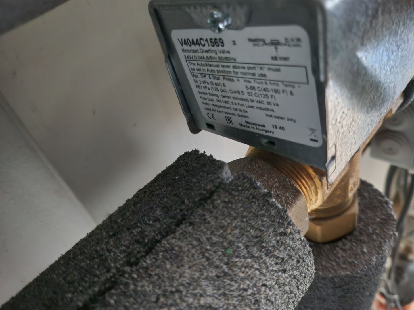

I dont think I have a mid port valve (I hope!) as I made that mistake in my last house and knew the issue  Picture of my valve is below.

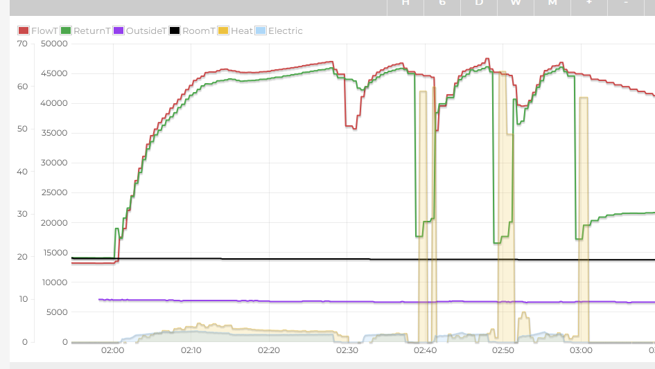

This mornings DHW run shows the same pattern. The flow rate is shown in red.

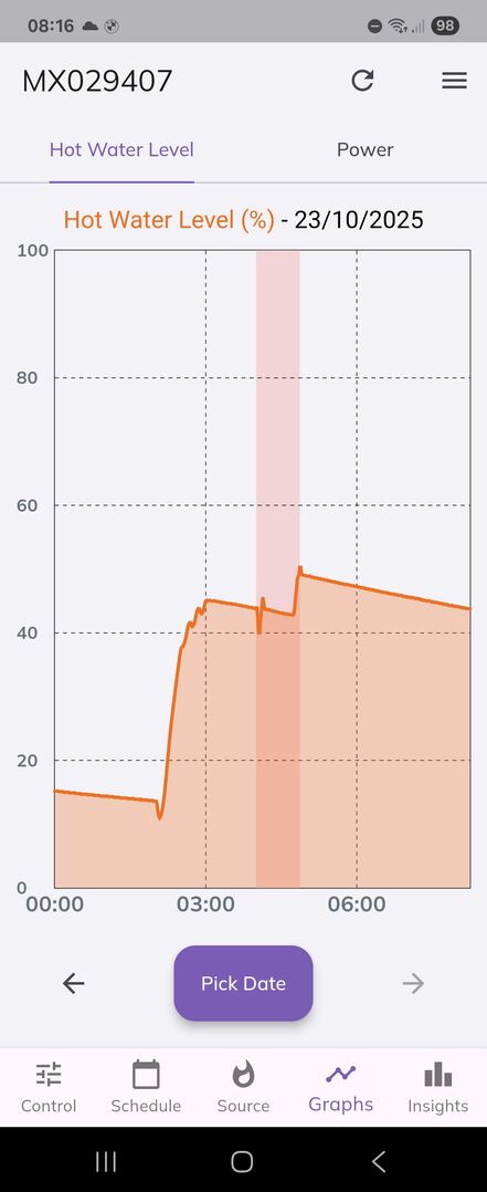

@old_scientist Yip Yip! it worked.
Screenshot 20251023 081605 Mixergy
So the DT was small, probably because the stratification pump is off and the coil isnt big, but it got to a 40% charge on its own before it was stopped and the immersion kicked in. COP was pretty dire though averaging about 1.4. Ill try it in eco mode now which should be slower and give the water more time to conduct the heat away.

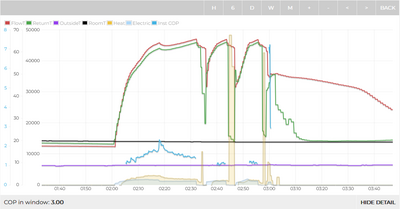

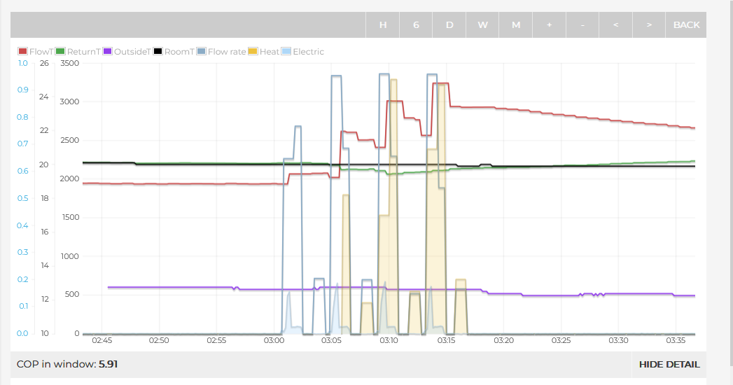

So this was last nights DHW run using economic mode.
Im a bit unsure as to what the actual COP was as it states 3.00 for the whole window, but the instanteous values are much lower. Either way its better than last night.
Ive knocked the target temperature back 5C and scheduled two 30 minute runs with a break for tonight. 🙂
