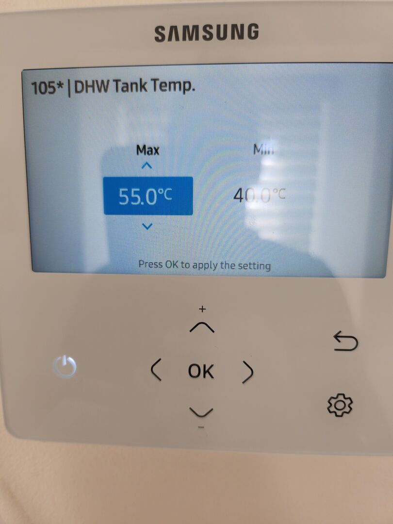

Can you check FSV 105*
Can you increase #3021 to 55C?

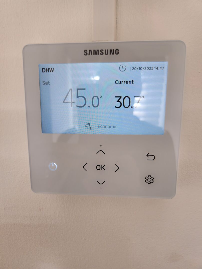

I know I set the heating mode to Economic but now cant find it again to change it back to standard!
What is a little confusing is that the DHW temp is dimmed at 45C and I cant alter it.

20251020 144759
It's dimmed like that because it's currently turned off.
It will either turn on/off by schedule (daily) or by manually turning on/off on the front panel using the power switch, illuminated on left hand side. You can only adjust the set temperature (45.0C as shown) when the DHW is turned on. When it's off (greyed out as in your pic), you cannot adjust it up or down.
To manually turn on, go back to front screen, move to RHS to select the DHW side of the screen and press the power button to turn on.
