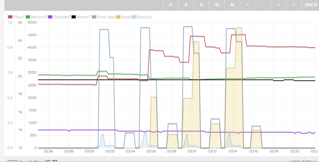

The schedule seems to start as predicted but after a few bursts just stops, as in the graph below:
My FSV values are:
3011 Use(Hysteresis)
3021 50C
3022 0
3023 5C
3024 5C
3025 95 mins
3026 3 hours
3031 Use
3032 95 mins
3033 0
3041 Not Use
Any ideas anyone? Thanks
6.9 kWp of PV
5kWh DC coupled battery
I think the mixergy coil is quite small, they sell an add on circulator and phe for heat pumps. I don't know how Samsung's algorithm works but is it possible coil is near top, once it's heated the water immediately around that's it, given a relatively low ft from the hp?
@jamespa That was one of my thoughts too, but looking at the flow and return temperatures that doesn't seem to be the case. The coil is about midway down the tank.
I also thought that perhaps because I dont have the mixergy heat pump control unit that the desertification pump probably isn't on.
Surely if these were the issue though the flow and return temperature would be close and why does it stop after just 3 attempts?
6.9 kWp of PV
What are the actual flow temps, the scale seems to be hidden.
Close flow and return indicates insufficient heat transfer.
Do you have the destrat pump. If so a good idea to run it somehow!
