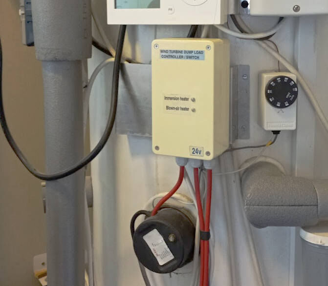

Yes, I have one in my Thermal Store.
In the days before my wind turbine caught fire(!) the DC Immersion was the 1st level of Dump Load.
I went through two DC immersion heaters, which blew open-circuit...
before coming across TP Fay, who make them in UK.

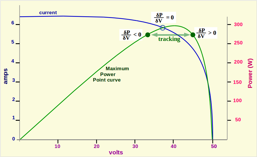

The panel requires an electronics device with an MPPT algorithm in order for it to deliver any usable power.
Without Maximum Power Point Tracking, the voltage will simply fall to the minimum level to match the 'near short-circuit' presented by the load.
The algorithm continually scans the input, and adjusts the current being drawn to keep the voltage at the 'knee' of the curve.

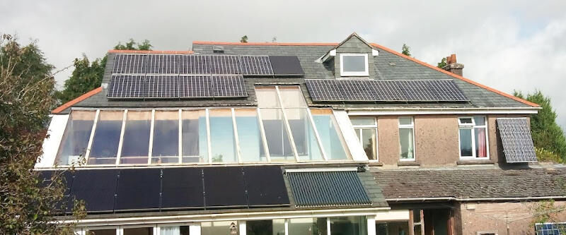

I have a single solar panel fixed to the south wall, because I ran out of room on the roof.
The output is acceptable, despite being in series with two other rooftop panels at a different angle.
There's also no problem with having PV panels completely vertical.
That orientation has been part of experiments to work out the optimal positioning for bi-facial panels.

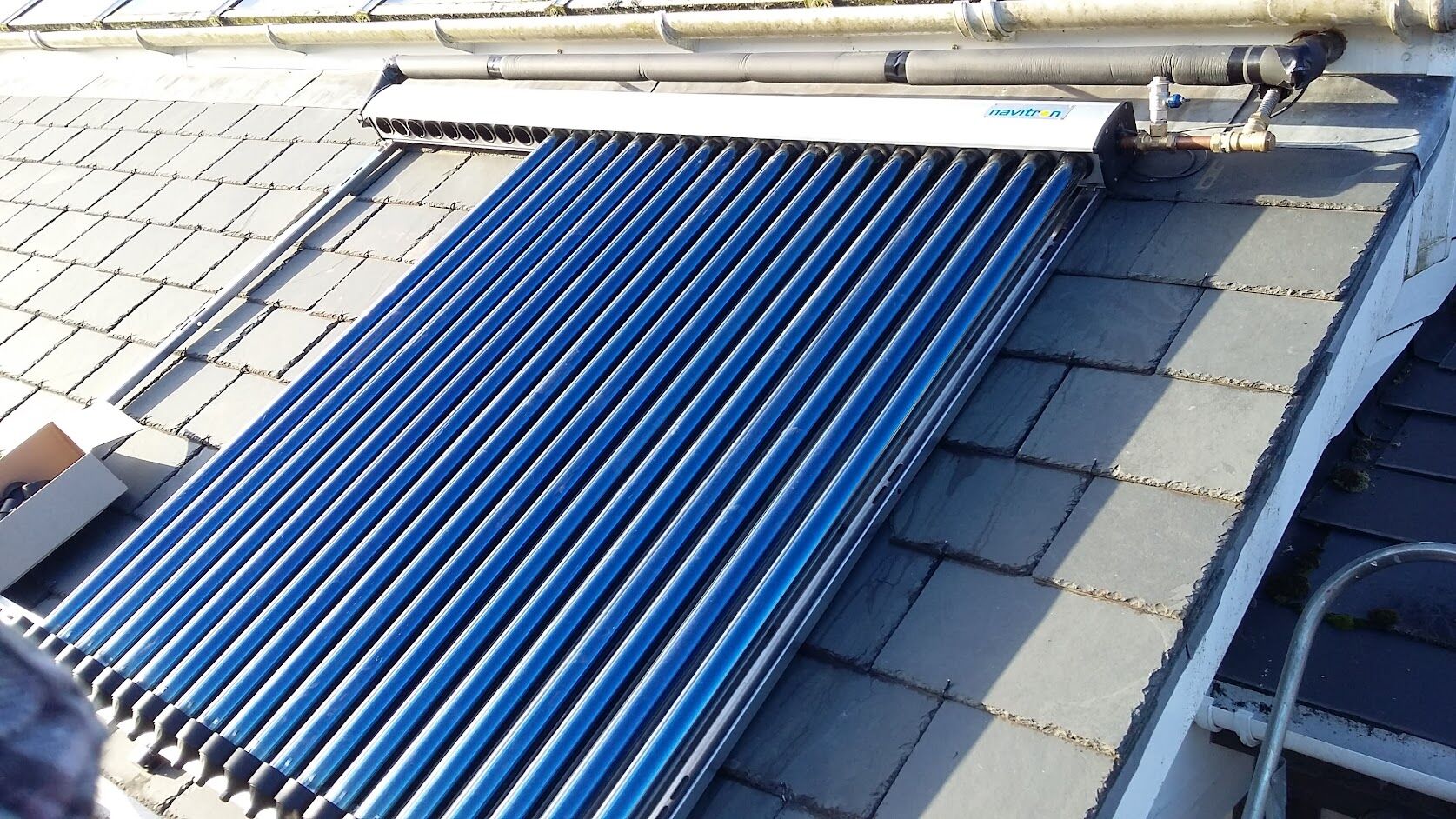

You will see that I also have a vacuum-tube-based solar-thermal array on my lower roof.
If it's just heat you want, then they are greatly more efficient.
PV panels can operate at around 19% - 20% efficiency in full sun.
Whereas solar-thermal will be at 80% and above.

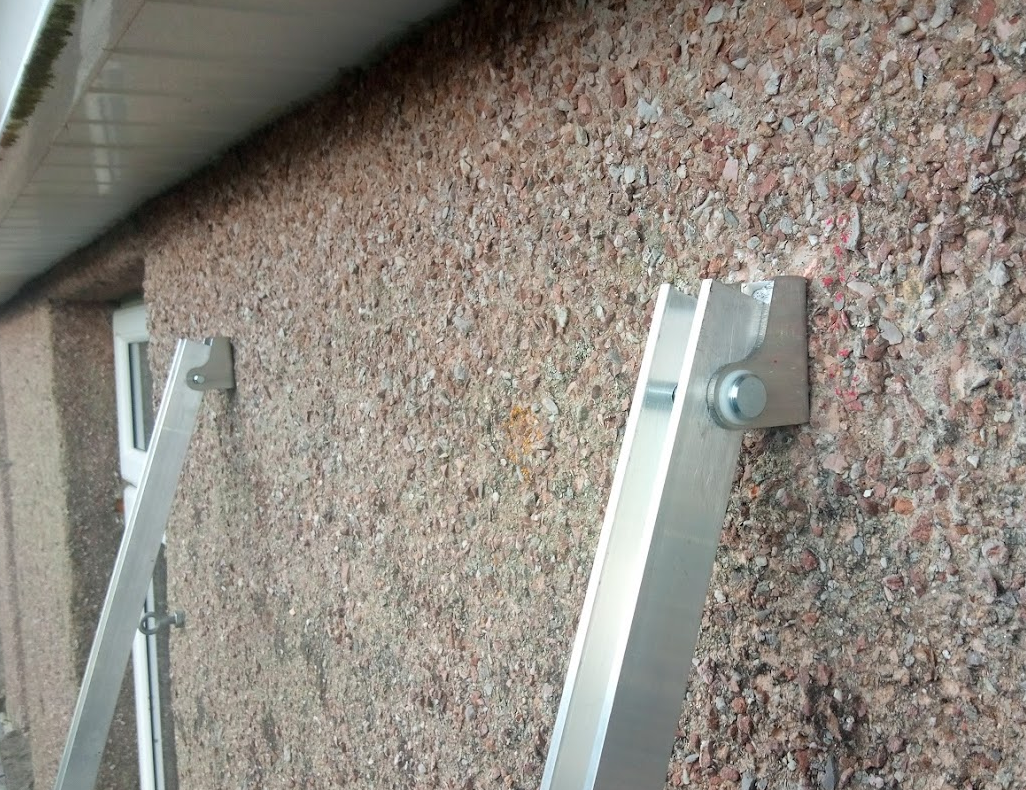

There are several designs of brackets and frames which allow PV panels to be held away from the mounting surface, as my own wall unit is.

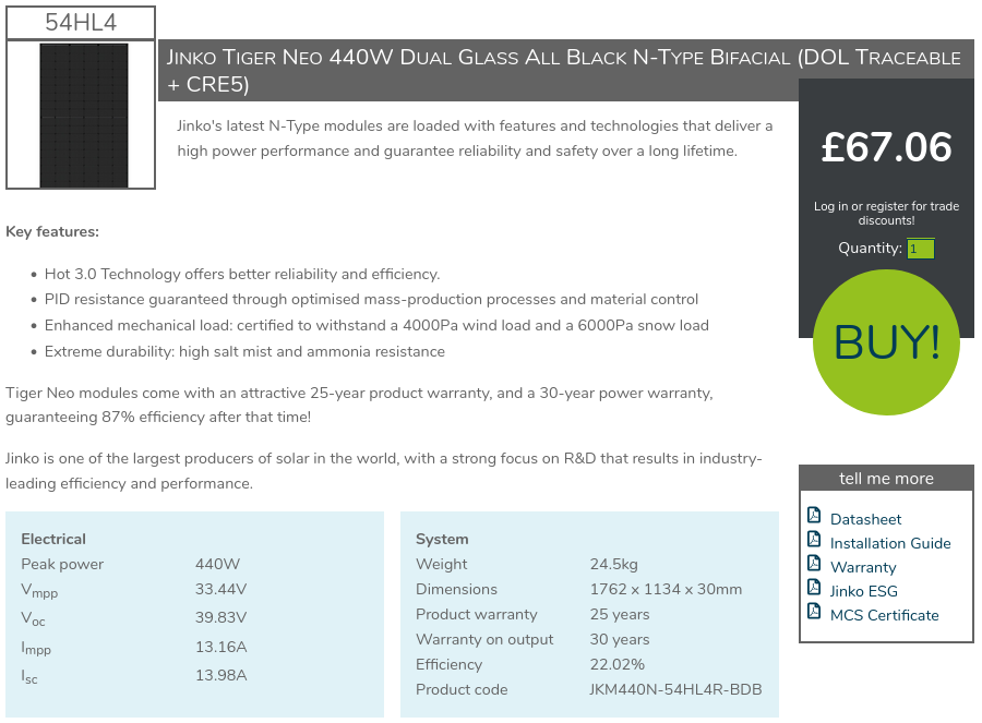

Midsummer Wholesale have several bi-facial panels available, including some 440W units from Jinko for £67 +VAT.

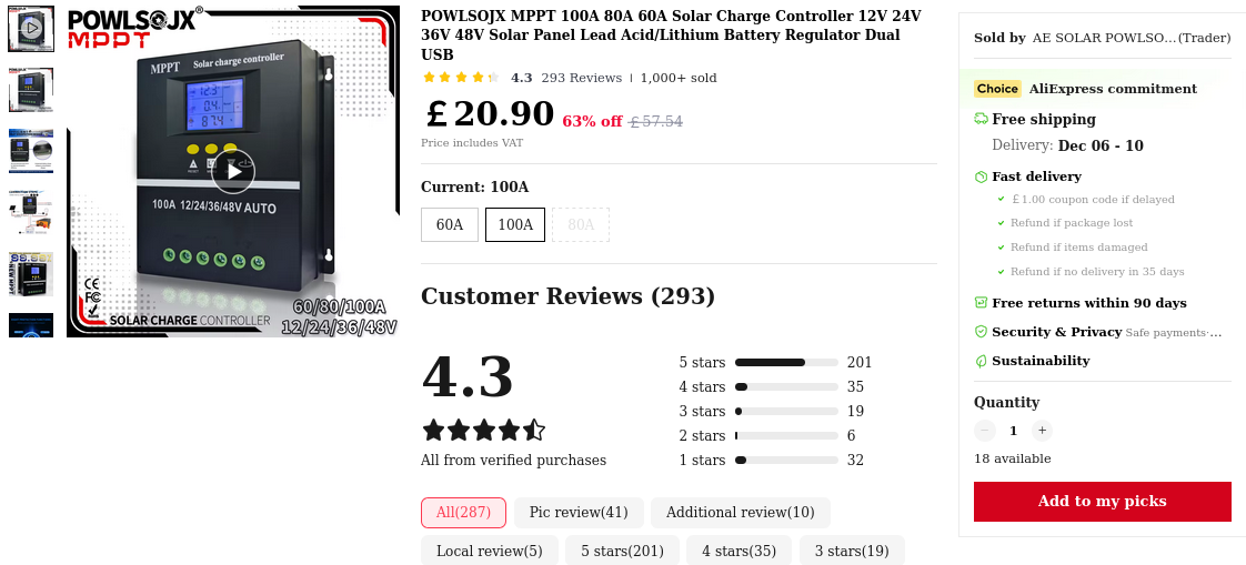

It's not necessary to buy a full-blown solar inverter in order to have an MPPT input, and then deliver 240v AC for an immersion heater.
There are also devices called MPPT Charge Controllers which are intended to allow solar charging of 12v to 48v mobile-home batteries.
Thus they output DC at whatever voltage is needed by your choice of battery.
It is, however, worthwhile checking that the unit really does operate a proper MPPT algorithm.
Some Far East manufacturers use the 'MPPT' term too loosely, simply to indicate that a solar panel can be connected.

Posted by: @transparentMidsummer Wholesale have several bi-facial panels available, including some 440W units from Jinko for £67 +VAT.
Amazing how the prices came down! 440W has to be mono crystalline ..
