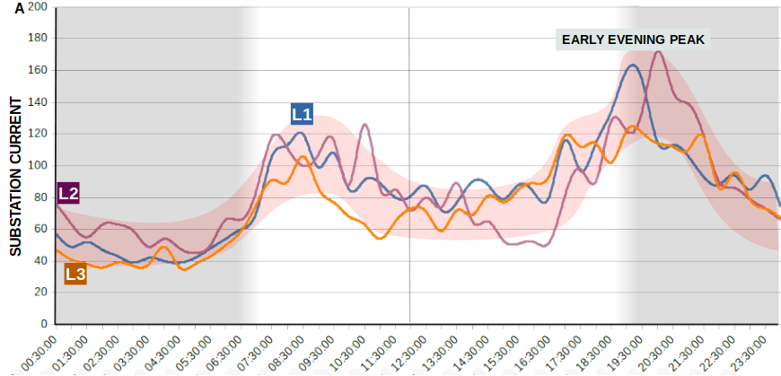

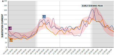

Not only are HA occupants the most vulnerable to fuel poverty, but they also account for the majority of pre-payment meters and don't have Time-of-Use tariffs.
Consequently, they are more likely to contribute to the national 'Early Evening Demand Peak'...
... and it's that which is driving the need to upgrade grid capacity,
for which we all pay through higher charges.
Taking all of that into account, I'd like to see HA's incentivised to install heat-pumps which are supplied with power via (off-grid) storage batteries.
The battery could also feed other in-home appliances, but not re-export to the grid.
That approach would allow all those homes to take no power at all from the grid during the Early Evening...
... which results in the Demand Peak being reduced...
... and the justification for massive grid upgrades being quashed.
